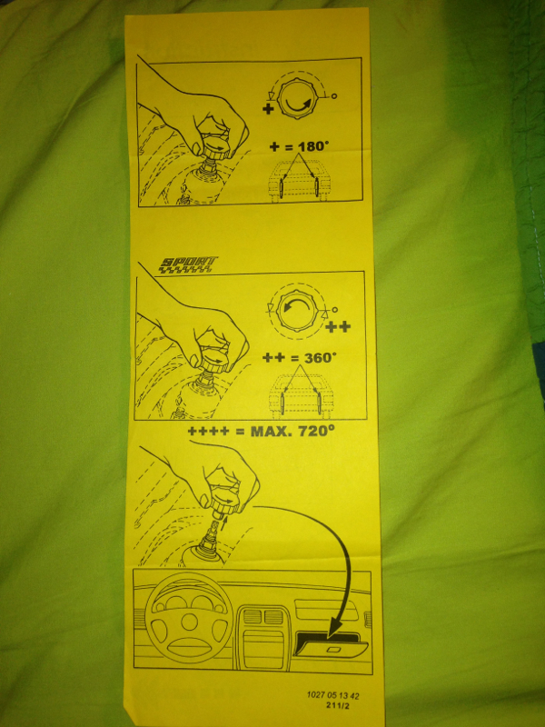

Here's some documentation from Koni. I hope it helps you out. As far as I can tell, there are no stops at full stiff and full soft.

Thanks for the Ikea-furniture like diagrams I've heard mentioned before but never seen! The first/vertical picture seems to confirm that between full soft and full firm is two rotations or 720º. It also seems to confirm that counter-clockwise is stiffer, so now I have questions four and five answered! Hopefully I'll get some definitive responses for questions one through three. Thanks.

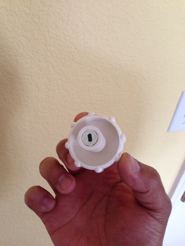

I am actually in the process of installing my Koni yellows and didn't realize that there is a stop at full soft and full stiff so I started fiddling with the struts and here is what I found:
1) You don't need to compress the strut to adjust as mentioned above.
2) Initially, I was just placing the **** on the adjustment tab and turning the ****, but I couldn't see a change being made in the setting. As I was doing this, the strut shaft was also turning. Upon closer inspection, I noticed the adjustment tab is a separate piece from the strut shaft as shown in the pic. So I held the strut shaft steady with my hand while I turned the adjustment tab and here is how I found the stop for full soft and full stiff.
3) At full stiff, when the strut is compressed, the shaft will not rise up. You have to adjust to a softer setting for it to rise up again. I guess this means that we should never set the Koni yellows on full stiff or else the car would always bottom out?
After reading this thread, I'm considering drilling the rear panel to make it easier for future adjustment.

MCS2011PT, thanks for the pics! When you say you didn't realize there was a stop at full firm or full soft, have you actually encountered this? Full soft is what I'm curious about "finding" as I only need one starting point to adjust from and most suggest starting from full soft.

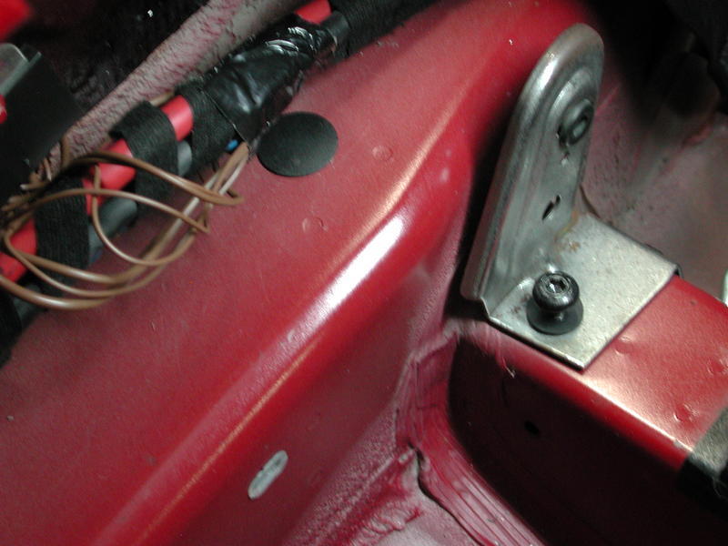

Just got through drilling the access holes using a 7/8 inch metal-cutting hole saw with a 1/4 inch pilot drill. Location is 2 inches inboard on the frame rail on a line from the rear of the cross brace. Just be sure to keep your wiring harnesses out of the way. To cover, I used black 7/8 inch hole plugs or you can use duct tape. (Anyone wanting hole plugs, just PM me...I've got plenty.) Only problem is the KONI adjustment tool is too short so you'll have to find or fashion another one that will extend deep enough. I got lucky and found an orange Briggs & Stratton "Touch-N-Mow" BS-695951 (or Arnold MTD #BSSK-10) lawnmower starter key that has the exact same slot in the end and has a long enough reach to easily adjust the rear shocks.

Looks good!
