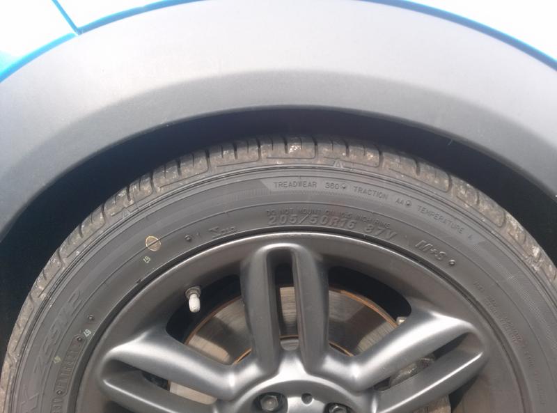

Thanks for the reply, Any added noise inside the car? Do you have any close up pics of the wheel and fender gap after installation. Thanks

There definitely isn't any noise from the springs that I can tell. The exhaust and motor mount on the other hand, are a different story. I'll get a couple of pics at work today of the wheel well gap for you.

Here are the gap pics as requested. First pic is front, second pic is the rear.
