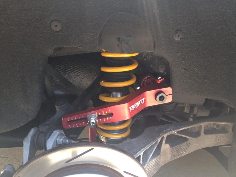

Holy crap I really disliked that swaybar install. lol. Cutting the stock swaybar took me longer than anticipated, but I'm happy to say it is finally on!
Meth kit is in today and control arms are in tomorrow. Busy week. Hope to get my alignment next wk hopefully.

Wow...that's slick looking. Talk about 'adjustable'

It's definitely a sweet bar. "The one to rule them all". :D

It pokes from behind there pretty well. It was $555 from Way which is probably the best price out there.
I considered getting the Tyrol FMIC but with the meth kit it almost defeats the purpose of having an uprated unit.

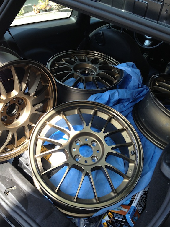

Oh! And I also didn't have much time because I picked these up.... :D
They'll need a bit of TLC, but I've been looking for SE37K's for a long time and I just couldn't pass these up on a local sale.

Nice wheels. Now you get to figure out what size tires you want to run.... Does it ever end? Isn't it fun?

Thanks Mike. I'll end up with the RS-3's on these Volks. So a quick transfer would be the case. Currently running 225/45/17 but when the thread is done I'll go down to 215 because 225 rubs the front arches. They need to be repainted so that'll be on the agenda. I don't know when it'll end but I'm close to where I was last summe when I was running stg3 AP. =P I just need fmic, and downpipe back to run a stg3 again but those things I'll get to later since this time my intentions are to make the engine bullet proof for the long run. With all the work put into this MINI I doubt I'll ever sell it. So yeah!

Very nice wheels, what are the specs?
