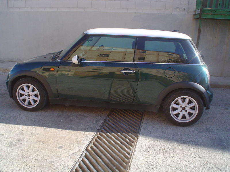

Yes. And with your Leda coils try to disconnect the front sway bar in the track, and you will be impressive.
The German MINI CHALLENGE R53 had the 16 mm MINI ONE sway bar at front, and std. R53 17 mm at rear, with BILSTEIN MOTORSPORT coilovers to improve traction, cornering, wet handling......
Really is better.
My justacooper is also a BRG.
Look:

What are those rims? I like the classic look, looking for something similar like the Rota RB's or Konig Rewinds.
And does a rear sway bar affect your rear tire wear? Does it make the back end slide laterally, or does it make the rear follow the front better?
The wheels are COMPOMOTIVE ML1571 7x15 ET38
The rear tire wear depends more on allignment than on the sway bar. The arb just works during cornering. It does the rear more agile and there´s no understeer without front sway bar, and much more less with a thinner at front than the rear, so you have to be a little bit more skillful with the steering wheel, throttle, and brake. But it´s faster in followed curves when you learn how to drive it.
What's the weight, quality, and price like on Compomotive wheels? never heard of them.
I've heard of Jeep drivers removing their front sway bar... that sounds like a bad idea. Or would it help?
The weight is above 9 kilos per wheel. Yes, a little bit heavy. They are top quality wheels made in U.K. used by many rally drivers around the world, mainly in Europe. The price is about 1000 euros for a 4 wheel set. You can order them with different offsets and colours to suit your car. It is the most MINILITE look a like wheel (original sixties and most popular aftermarket wheel).
Website: www.comp.co.uk
