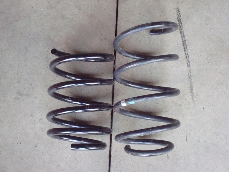

Here is a picture of the stock sport spring and the TSW spring for the front. I forgot to get a picture of the rear. Since the factory spring is taller, there is more preload to get it installed. That is why I recommend using the spring compressor.
Mike
