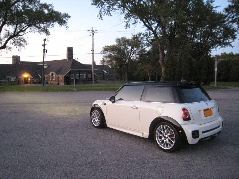

Final product (maybe)
What size spacer did you end up having to run? And what tires? size, etc..??
I'm running 215/45 Conti DWS and I'm using a 5mm with the spring perch all the way at the top. You look lower than me so I'm guessing about a 10mm spacer?
You're at the TOP? As of tonight I'm 7 threads from the bottom. The back is a bit harder to adjust and it doesn't seem like it would lower as much as the front.
I have 205/45/17's. I keep forgetting to measure but I'm pretty sure I have 5mm spacers (car came with them).
