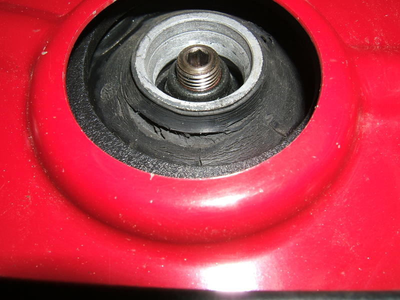

I haven't contacted Ireland Engineering yet... but do you have any radial cracking in that 'rubber like' BMW bushing? Mine started cracking after 15 months and now at 27 months looks like they may fail.

I have been out of town for a couple weeks but now I'm getting back to my bearing-bushing radial cracks problem. I think these are BMW Z4 pieces that Ireland Engineering attaches to their fixed camber plate product.
In my case the IE fixed camber plates bearing-bushing had some cracks at 15 months with only 5366 miles. 68 of those miles were on a paved road course circuit, race track. I'm at 27 months and 9873 miles (total of 90 track miles) and they have severe radial cracks or tears. I'm using DOT tires and not run flats.
Anyone else having this problem besides 'donjulio'?
I am sending this to Ireland Engineering to see what they suggest.
The first photograph is of the right front strut top bearing-bushing with radial cracks or tears. Second photograph is the left front with bearing dust cap removed.
11 October 2011 Update. Jeff, Ireland Engineering, agreed that the condition of these upper strut bearings is abnormal and he is helping me get this corrected. I bought the product from Dustin at AutoXCooper and he has been very supportive as well. A big thanks to Jeff and Dustin.
