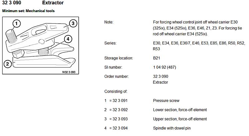

1-Has anyone seen a write up for tierod replacement?
2-Does anyone know if the generic tierod tool from autozones free rental selection will get the job done?
thanks

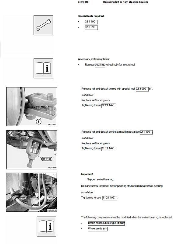

I dug these up for you:
Tools required
And instructions:
Attached Thumbnails tie rod replacement-miniknuckle.jpg   tie rod replacement-miniknuckle2.jpg   tie rod replacement-miniknuckleinstructions.jpg

thank you for that. Do you know if these tools can be rented from autozone?
Old Aug 2, 2010 | 07:37 AM
JustinGTP's Avatar
JustinGTP
Joined: Apr 2009
Posts: 845
Likes: 12
From: Calgary, Alberta
No idea, this document is from BMW/MINI. You might want to print it off and take it with you to show AutoZone and they can see if they have anything that will do the job.
