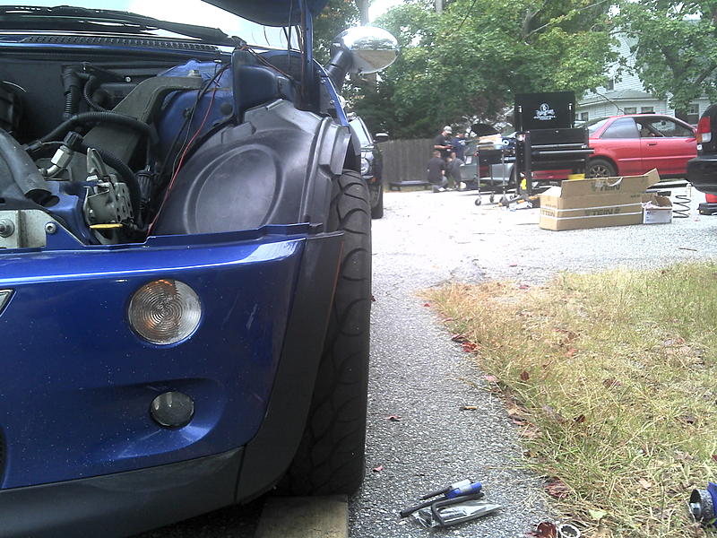

The camber is WAYYYYYY off! The passenger side is fine. We took it apart and reassembled it. I'm thinking the wheel bearing hub must be miss aligned and is slightly tilted. The strut mount plates are fine, and they both are sitting like mirrored versions of one another. This is the only thing I can think of so I will have to take a look at it again tomorrow and hopefully it'll be the cause of this issue. I just ran out of time this weekend, and I'm working today so tomorrow will just have to be the day to take it apart.
