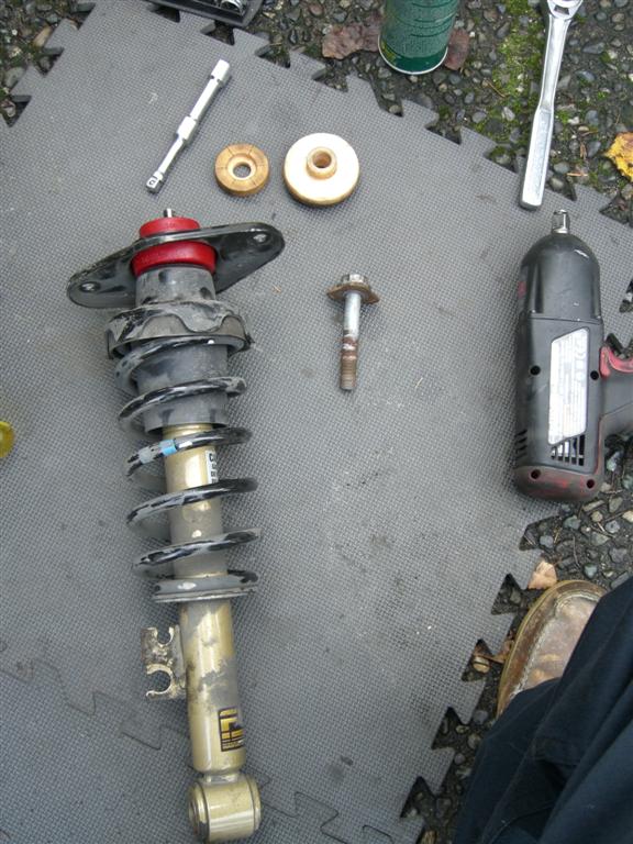

****'s Garage - sorry, I did not take any pics. However, here is a decent pic I found. You can see the two factory rubber bushings sitting just above the strut. It looks like they replaced them with poly bushings in the pic. Anyway, there is a sleeve that goes inside them that fits over the strut shaft. I had to drill out the sleeve a little bigger to fit over the larger Cross shaft. I also had to drill out the OEM cupped washer to fit over the Cross shaft, but that was much easier since it's thin. None of it is hard, I just wasn't expecting it.

Originally Posted by Spooled
Thanks again OctaneGuy! The car feels so much better already, and I haven't even had an alignment yet. Doing that on Wednesday. I hope driving around without one eats these dang runflats quickly so I have a good reason to buy non-RF's.
Side loading, eh? Interesting. I suppose the stock rubber bushings allow the strut to articulate a bit, decreasing side load. I'll have to look into that. Thanks for the heads up.
