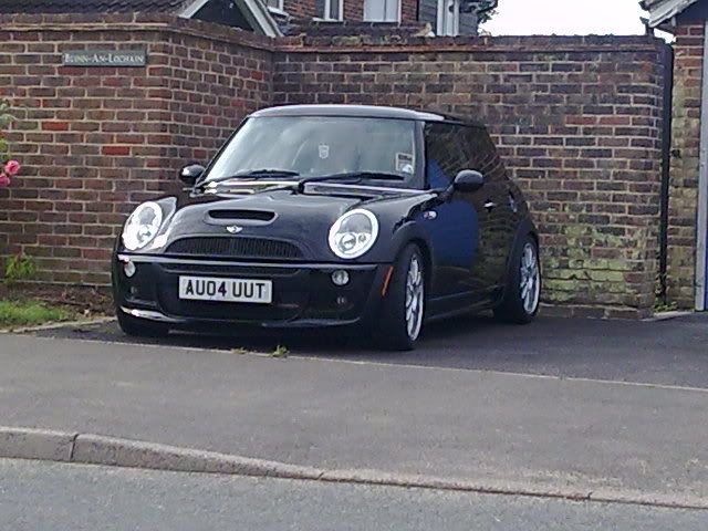

Pretty good IMO - equivalent to JCW springs from the JCW suspension but just a nice bit lower.... slightly firmer but that just means slightly less body roll = good.
I have 35mm H&R springs on JCW shocks - perhaps the great ride that I have is in part due to the improved JCW shocks too....
