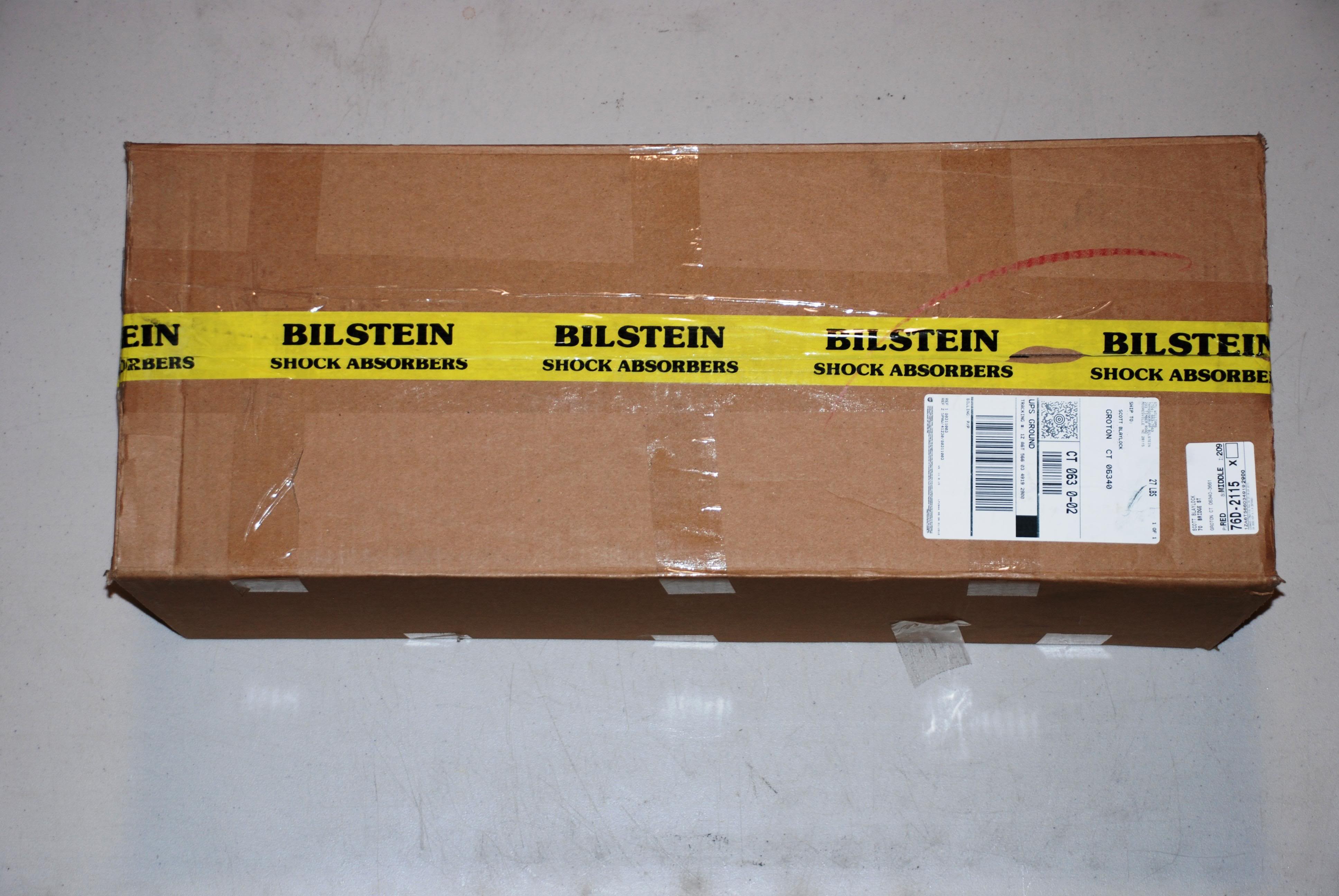

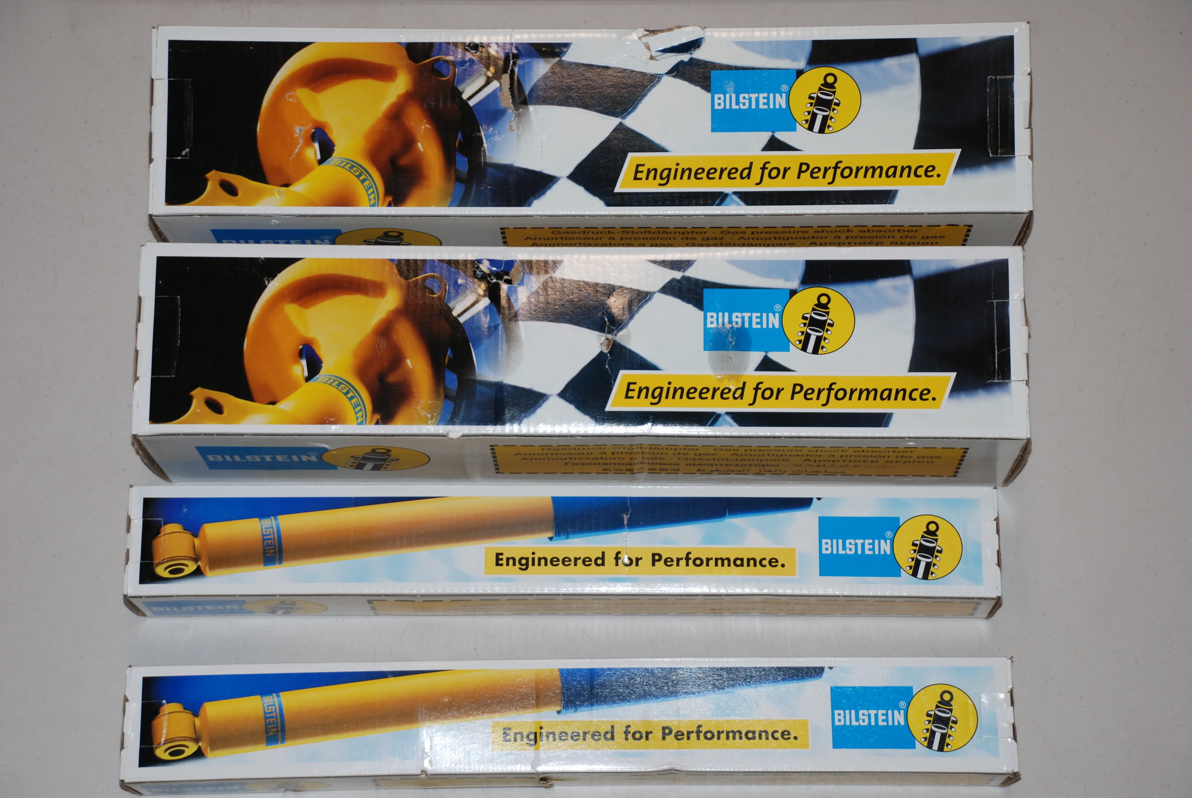

The project begins.....................

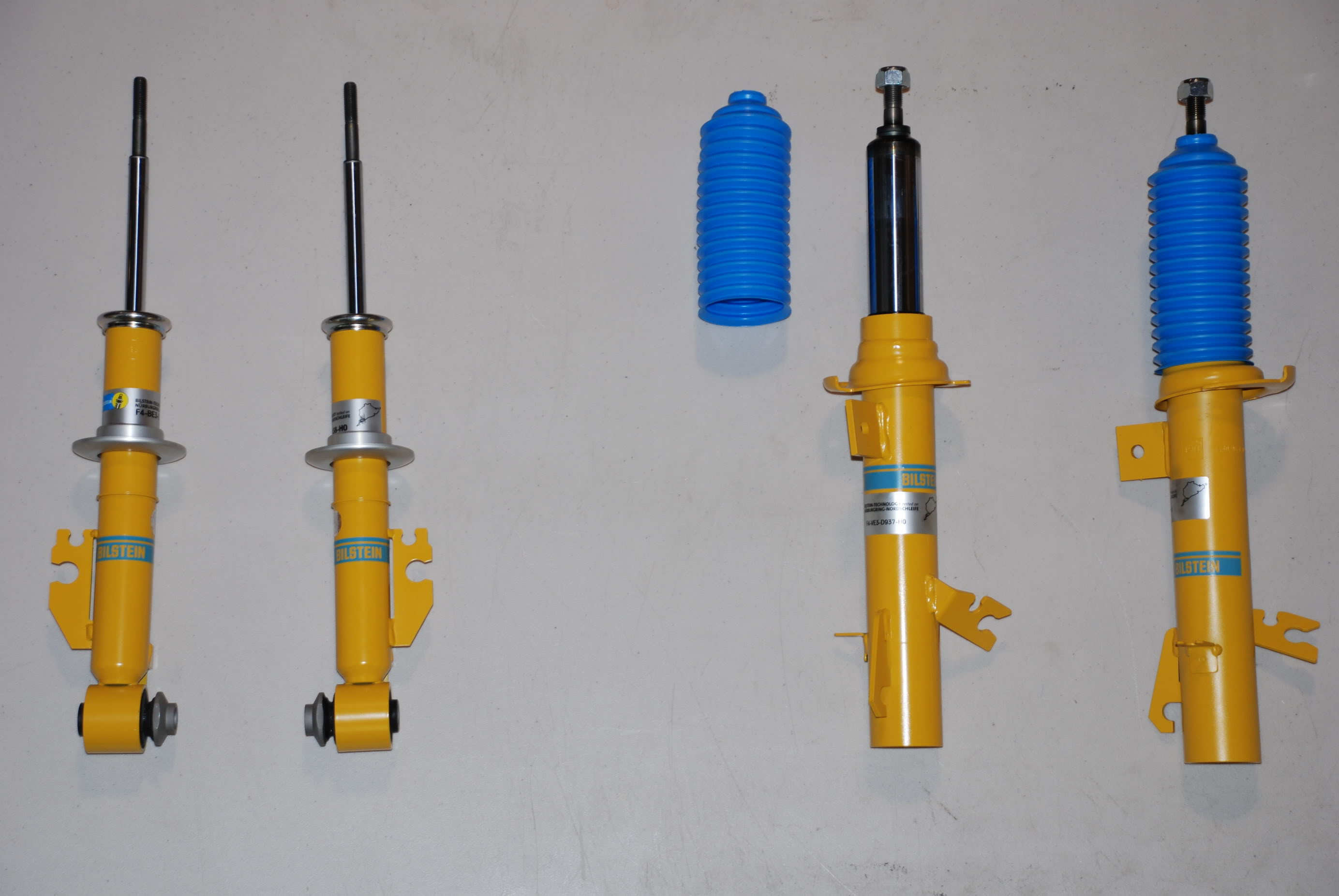

All the work is complete and the job went outstanding!!! As for the results, add a set of Bilstein HDs to your MINI and they will give you a reason to fall in love with your MINI all over again.
As for drivability, here is what we immediately noticed:
No more front end lift on launching or heavy acceleration.
No more nose dive during heavy braking.
A much smoother ride compared to the OEM equipment
Much better ride over pot holes and rough roads.
The MINI does not lean or dip Going hard into a corner
DSC activation while traversing a rough spot under acceleration is gone. The wheels remain planted to the road.
On a side note, they just look good!
Over all dimensions are far as fitment is concerned are the same and the fit is perfect.
The diameter of the rear strut piston shaft is about 1/16“ larger on the Bilstein HD. (Check the pictures when the link is added)
The Diameter of the front strut piston shaft is about 5/8” larger on the Bilstein HD. (Check the pictures when the link is added)
Thank you Hotel 2-5 for your help and photgraphy expertise today!
