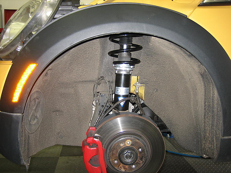

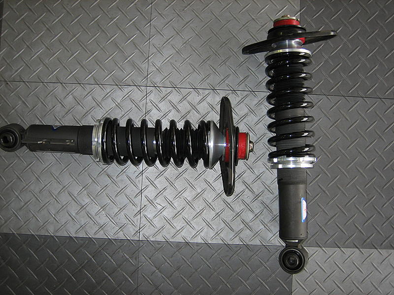

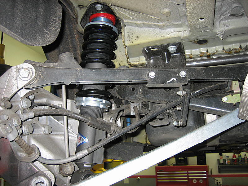

Height and damper adjustable M7 coilovers were $1500 plus $40-$50 for the rear lower metal bushings that are needed. The firm red bushings from Mini Madness replaced the soft stock foam bushings on the rear tops. Then added the rear lower control arms and Alta PSRS. I felt it was best to get everything right, have it done in one day, and only do it once.
Attached Thumbnails My two options...-108-005.jpg   My two options...-108-021.jpg   My two options...-108-019.jpg

Nice setup...and I agree with you. Though I'm not gonna go as lower than posibly 1-1.25 inches at the most.
How is the ride?
