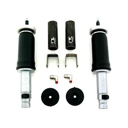

sorry phillip but bsandgat is correct - unless you have the old school air shocks where you hook up a compressor to them and change the internal pressure. Those are for LIFTING and not lowering.
