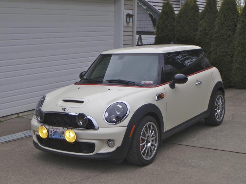

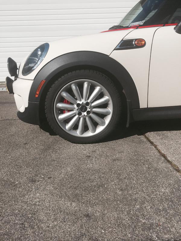

Originally Posted by kyoo
lol, let us know how the suspension goes.
I have not had it aligned yet but the Butt-O-Meter say a wee bit softer, as far a jarring, than the OEM Sport Suspension. It lowers the car as advertised and seems to do it in a manner that it not Butt high(used to look like a Stink Bug); looks pretty good IMHO.
It is not as smooth a ride as the FSD's on the Sport Suspension springs, so as far as comfort goes not as nice as the FSD's.
I will drive them a bit after alignment before I decide to keep them or go back to OEM Sport Suspension springs and a different shock.
Here is a before and after shot of the profile and a wheel shot after lowering.
Attached Thumbnails R56 lowering springs: options and specs-p4110017.jpg   R56 lowering springs: options and specs-img_1456.jpg   R56 lowering springs: options and specs-img_1457.jpg

^you're on sport springs + the bilsteins?
car looks great btw

Thanks, but they are on Swift Spec-R springs and Bilstein B8's.
The Sport Springs and B6's might keep the OEM height and better ride than the crappy MINI shocks.
