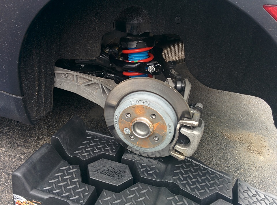

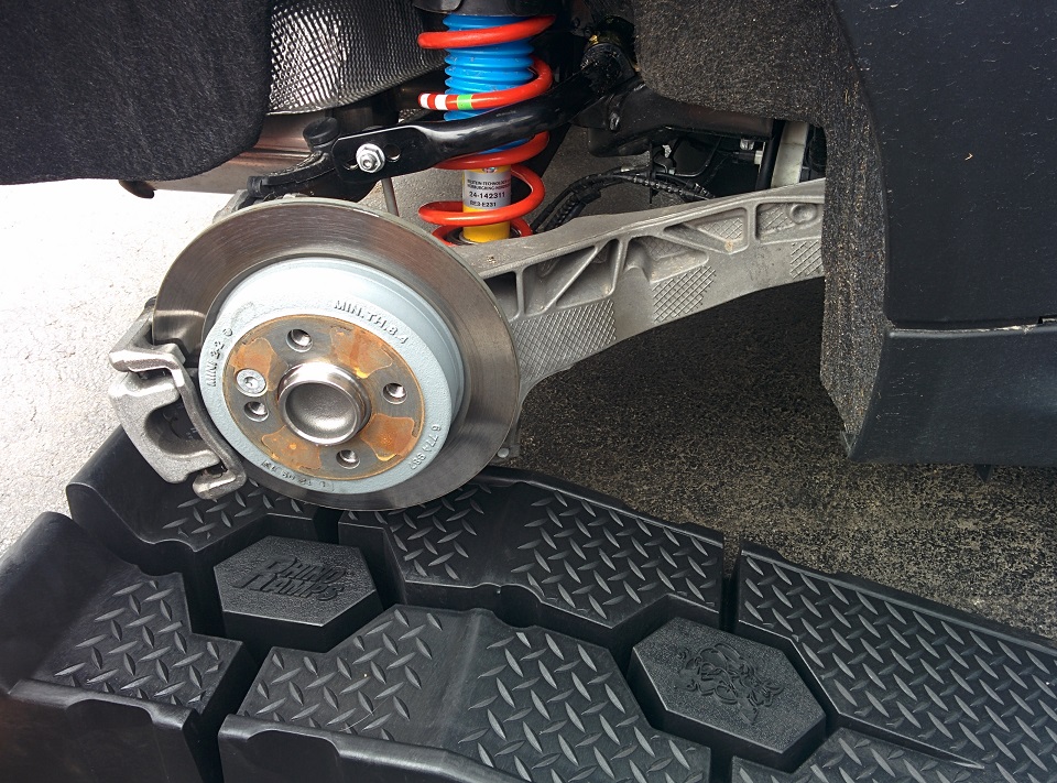

can someone confirm this for me: sway bar endlinks should be tightened while the car is lowered on the ground, not while it is up in the air?
I found these instructions by one supplier and I'd be pretty sure that the procedures would hold true for any adjustable link. Lots of good stuff in this thread to catch up on.

thanks i think we're good. we used ramps to load the suspension to tighten the endlinks lol:
http://r56hs.com/2014/03/29/fat-cat-...pension-is-in/

Not the prettiest thing in the world, but very very effective. had my first autox today. it was the bomb
