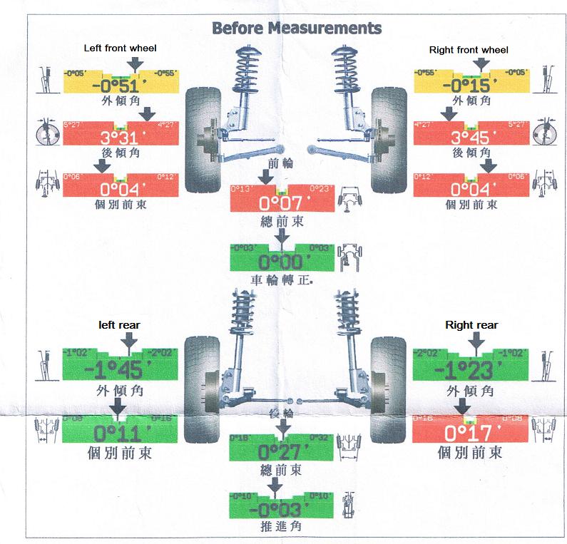

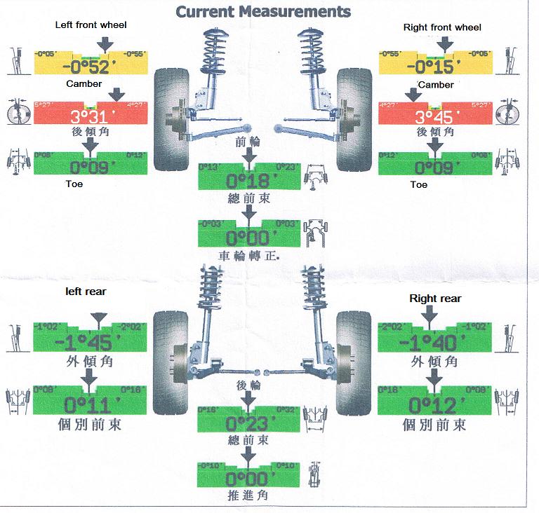

How to read the result?
I just did the alignment, is it a good setup...
sorry, i just modified the before with English, i guess you can guess the setting....if not, i will change all into Eng....
thanks...
Attached Thumbnails lower with Eibach - alignment-before.jpg   lower with Eibach - alignment-after.jpg

They should have given you more - camber on the front right. There is a hold down screw on top, remove it. Then loosen the 3 top strut screws and move the top of the strut towards the engine. The holes are slotted.Easier if you raise car to get weight off tire.
On the right rear they gave you more - camber, you want less in rear.
Maybe the left wouldn't come in anymore, so they evened it up.
Hope that helps. You could think about buying lower rear control arms and taking more of the negitive camber out of the rear.
http://www.altaminiperformance.com/p...r-Control-Arms

you can adjust front camber on a stock mcs?
Old Mar 10, 2008 | 04:05 PM
th3118's Avatar
th3118
Coordinator :: Dynamic MiNi Collective
Joined: Jul 2002
Posts: 591
From: Chandler, AZ
Yes, on the R56 you can get almost .4 negative camber if you follow the above procedure.
Old Mar 10, 2008 | 04:12 PM
ThumperMCS's Avatar
ThumperMCS
Joined: Feb 2006
Posts: 3,582
Likes: 19
From: OC, CA
Thats cool to know!
