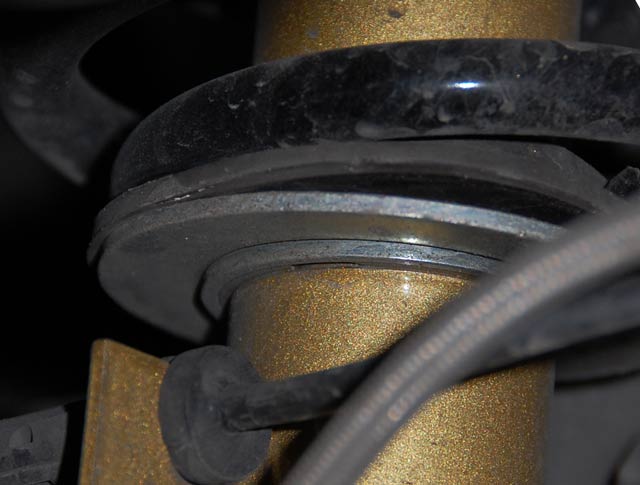

The lower spring perch is flat with an inner sleeve, the sleeve should be on the top side, the flat part of the perch rests on the ring welded to the shock body. Can you take a close-up photo?

I’m not sure the instructions would help even if you could locate them; the drawings are not easy to understand. When you put the lower perch on it seems counter intuitive for it to be able to rock so installers will place it upside down on the collar/sleeve because that is the more stable position. In this photo, notice the perch collar/sleeve can not be seen beneath the perch.

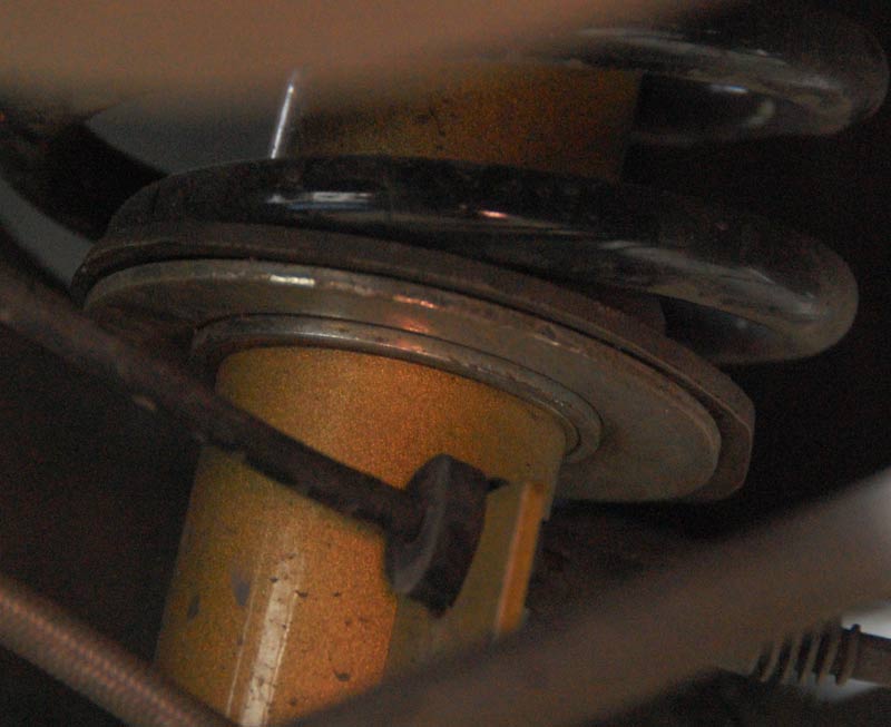

Thanks. Just snapped some pics, and it seems as if they're similar to yours.
Images attached

Now look at the upper mount, but that one is hard to mess-up. Without removing the struts I don’t know how you could tell if the left & right were reversed or the upper elastomer bushing had been placed below the mount. I could probably put my fingers up there and tell but I’m familiar with the arrangement. You could give that try, remove the wheel, slide some fingers over the upper spring seat and feel for two bushings, but I’m having some trouble fathoming how it could be assembled that way without the installer noticing something wrong. Beyond that, I would give it about 50 miles to see if it settled some.
