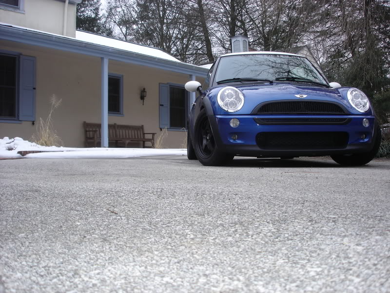

The Pss9's really can't get slammed. This is a pic of Pss9's spun all the way down with no more thread.....it's low and definitely looks good like this, but the other coilovers could go further.
Juniormints ride

Looks like he cut of his airdam to get some ground clearance back.
I believe he did....or removed it, i forget.It still isn't as low as some of the other options.
**don't mean to sound like I'm saying Pss9's are bad.....they have gotten a lot of praise on the track etc......but in terms of this thread, they don't offer the same adjustability as the others**
