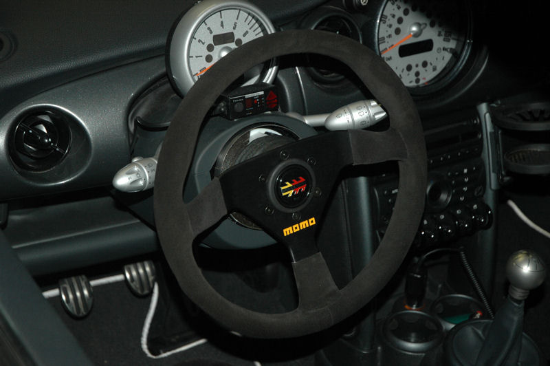

Originally Posted by PGT
I miss that Momo wheel. <sigh> Stupid airbags.
We don't need no stinkin' airbags... with apoligies to the SNL Killer Bee's
Old Aug 22, 2007 | 08:03 PM
  #92
Ryephile's Avatar
Ryephile
Joined: Jan 2003
Posts: 9,009
Likes: 36
From: Metro-Detroit
Nice wheel gnatster! Whose adapter are you using? [gets notpad ready to save info for the future! LOL]
Old Aug 22, 2007 | 08:04 PM
  #93
PGT's Avatar
PGT
iTrader: (11)
Joined: May 2006
Posts: 7,681
From: DC Metro
looks like the standard Momo collapsible one like I had for my CRX
Old Aug 22, 2007 | 08:22 PM
  #94
gnatster's Avatar
gnatster
Joined: Jan 2007
Posts: 3,952
From: Ohio
I got the info here...
https://www.northamericanmotoring.co...0&postcount=11
Pictures are gone, might want to contact orginal author to see if he'll repost.
