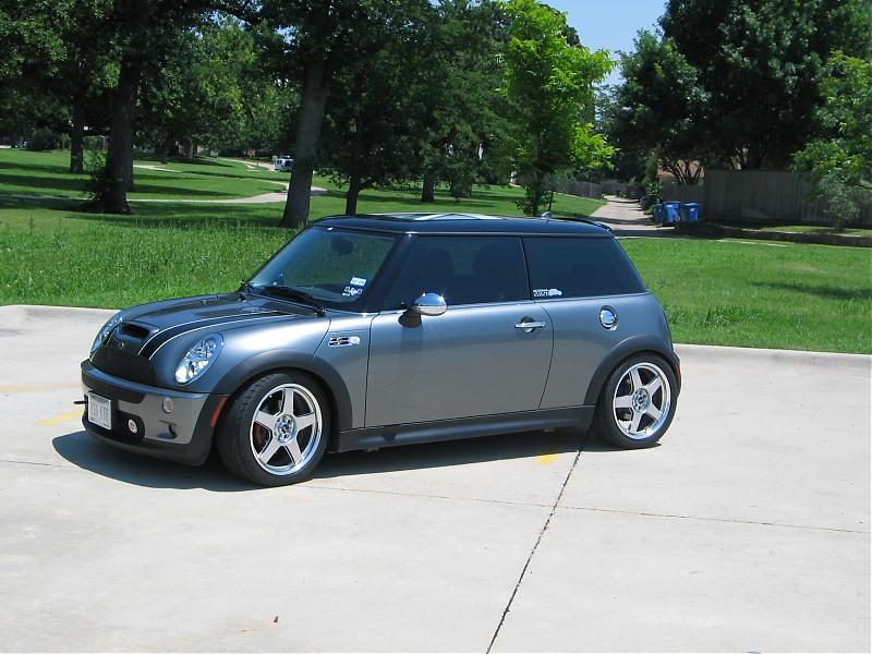

I have TSW springs with IE adjustable Camber plates.
My car sits a little lower because it is an auto and has the sunroof.
No problems so far.
