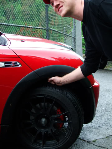

Old May 18, 2007 | 05:59 PM
minimusprime's Avatar
minimusprime
Joined: May 2006
Posts: 1,429
From: Flying My Roflcopter
not all hsports are created equal... ask around many will agree. That's why i said my hsports. Also I've had my car bottom out several times on bumps that it would just soak up with stock springs. I may have the same suspension travel, but im using all of it now. take that however you want...
appologize for ot but i have to prove a point i guess.
a fist full of wheel gap:
to this... 1 finger
I'm done arguing with this thread. I don't care if you buy fsd's with lowering springs. I wont do that.
