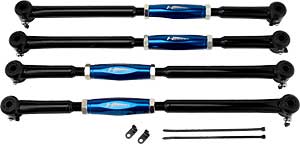

I just want to pass this along, when I lower my R56 I notice that the camber on the rear need it to be adjust, the way to bring the stance from the squat look to normal is with adjustable camberlinks. I did some shopping around and saw ALTA, HOTCHKINS and a few more out there.
Well I just found out that the difference between the R53 and the R56 is 2mm. which mean that we can use the same camber links as the R53.
TireRack has a set of 4 HOTCHKINS for....are you ready for this?? $305!!!!
mine were $322 to my door. the lowest i found them is $240 for the set. I am doing the buddy system with a fellow R53 owner so I'll end up paying 1/2 of 322.. Not Bad Eh??
They have low stock at that price...

I just replaced the rear lower control arms on my R52 with the Hotchkis arms you're getting. The fit/finish is great, the adjustment feels smooth and precise, and the center turnbuckle is large enough to turn by hand once you loosen the locknuts, so they're easy to adjust and you don't have to worry about scarring up the anodized turnbuckles by using a wrench on them.
The zerk fittings for greasing the bushings are nice, too. The only problem I had was that the dust covers for the upper (inboard) zerk fittings are almost impossible to put back on after greasing the bushings, since you hardly have any room to get your fingers in there. I'm hoping that being tucked up that high, the upper zerk fittings would get that much dirt and crud on them.

No need to get 4. Replacing the 2 lower arms will let you adjust the camber. Toe can still be adjusted with the trailing arms.

Yes you are right, thats why is such a good deal, if you find a buddy who would like to share a set the price is unbeatable!!!

The difference between the lower set betwen the R53 and R56 is 2mm...NOTHING that why this set work fantastic.

$305 for a set of four is an amazing price - I paid $239 for a pair just a few weeks ago.
One other note - the locknuts on the control arms are pretty big (1-1/8"). I didn't have an open-end wrench that big, so I used an adjustable wrench for the initial installation until I could get the appropriate-size wrench. If you don't already have the right size wrench, you might want to pick one up while you're waiting for your arms to arrive.
Also, if you don't already have a grease gun and some lithium lube, you might want to pick some up. The arms came with those single-use packets of lube, but it's easier and cleaner to just install the arms with dry bushings and then lube them up with a grease gun after they're installed. Even if you use the included packets for the initial installation, you're going to want to re-lube them someday anyway.
Removing/replacing the upper (inboard) bolts was the only tricky part, just because there's so little room to work. The nuts are 18mm, and you'll also need an 18mm wrench to back up the bolt while you loosen the nuts. My metric wrench set skips from 17mm to 19mm, so I had to stop in the middle of the project to go get an 18mm wrench. I was able to loosen the nuts with a slim-head 3/8" ratchet wrench and a universal-joint socket adaptor, but it would have been easier to use a smaller 1/4" ratchet. Problem was, I didn't have an adapter to use my 3/8" sockets on my 1/4" ratchet wrench.
Note - I just realized that the 18mm size for the nut/bolt and the "hard to reach" part might not still be true for the R56, but I left the above paragraph there just in case.

I got the set of control arms yesterday I had them installed today & they look great!
I also got a four wheel aligment and the little beast corners beautifully, and I do not have the squat look, which I do not like.

Well I should said negative camber, to me after I got the springs in the rear looked like it was squating. and I didn't like it. The picture is in the process, tomorrow I will take a good photo of the rear end and you can compare to yours.
I could not adjust the toe without the new arms, now the car is back to almost factory setting, I do not do track it or super agressive driving but I wanted to wear the tyres evenly.
The numbers I got now are:
Front 0.25
Rear 0.40
Looks the way I like it.

Everyone knows that the stock rear lower control arms already have eccentric cam bolts for camber adjustment, right? This has been the case since the '05 model year on the R53.
I had H-Sport arms on my '04 MCS. They're very nice arms, easy to adjust, but take my advice, use anti-sieze! After 2 years the arms rusted into place, and wouldn't come loose. H-Sport actually offered to replace them for free, but I didn't need to adjust my camber anymore either, LOL.
