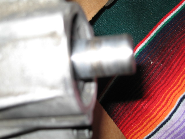

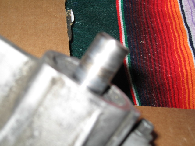

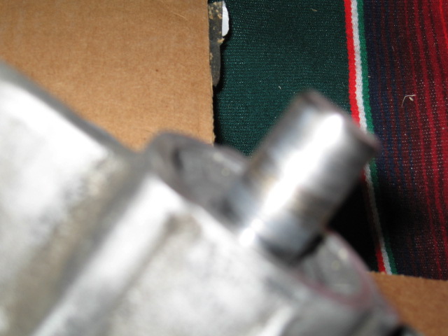

to all my friends:
i have 02 cooper S with 40000 miles, still under waranty.
mods = 15% pulley Alta, exhuast, Cai.
my SUPERCHARGER Faild do to bad bearing and you knew the dealer did not cover it.
the dealer stated that is do to the PULLEY mod.
The car runs fine at idel but as soon as gets to 2000 RPM thats where you can hear the loud klanking and Cliking noise.
so how can this be, so many cars out there have this mod 15, 17 even 19% pulley and the only one that i knew is gone bad is mine.
after doing much research on this and talking to alot of friends and mechanics.
i had my car fix and it was not CHEAP . i had no other choice.
i could not belive what i saw my supercharger shaft looks like a screw!
i have been showing the old SUPERCHARGER to alot of mechanices that i knew from the club and out side.
it seems that my pulley played or moved or mechanics terms (WALKED) on the shaft of the supercharge this very evedent because you can see the groves on the old supercharger shaft thus making the supercharger bearings good bad.
i have taken some pix for you to see.
i will be talking to ALTA and the Installer in regards to this to see what happend and who is resposibale?
Attached Thumbnails Supercharger Problems !-img_0018_3.jpg   Supercharger Problems !-img_0020_3.jpg   Supercharger Problems !-img_0019_3.jpg

Those pulleys attach like a standard industrial taper lock bushing. The engineering principle is sound, but the good Doc is right that the whole setup would be much better with a Woodruff key in the mix.
My theory is that the bearings went bad and the increased torque load is what "spun" the pulley on the shaft and chewed up the shaft. You'll never prove it in a million years, but I bet that's what happened. There are threads out there that document oil loss in the supercharger's gearboxes.
Your pulley caused that bearing to fail in the same way that flies cause garbage....
