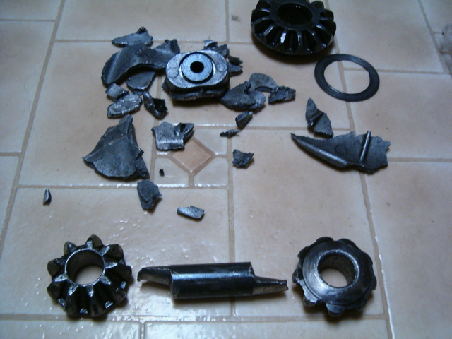

Hello, I just returned from an autox in which the transmission on my July 04 build, 2005 MCS literally broke to pieces on course. It was not during or even soon after a shift or launch. It happened while the car was making a turn. We heard a clunk sound and then the car limped to the side. Meanwhile, pieces of my gearbox exploded and fell out from under the car. Of course, fluid was everywhere.
Upon close inspection of the remnants of my transmission, I found that the shaft that holds the two spider gears appears to have been chewed on both ends to the point where I believe one of the gears just fell off / was sheared off and caused the resulting catastrophe.
I've tried searching and can find no one else who had this particular problem. Is this shaft known to be weak or am I just lucky?
Based on the appearance of the damage it would appear to be caused by a weak metal in the original part that has caused progressive wear over time. This fits observation, as we had taken the car in to the dealer several months ago, complaining about excessive motion in the drive train. They replaced a couple of motor mounts and this seemed to help some... However the underlying problem was still there. The dealer refused to closely examine the transmission because they claimed the problem was with a worn clutch, which I disagreed with. They wanted $900 to even look at the thing!
The original complaint to the service dept. detailled a problem in the gear box because that was clearly where it felt like it was coming from. The car was difficult to shift into gear in the morning and would get easier as the vehicle warmed up. I am also wondering based on this wear if the "clink" sound we used to hear when taking off in first gear may also have been related to this as the source of that sound never was tracked down...
So this leads us to present day. A dead gear box, a perfectly fine clutch, an undriveable car. I just wish the dealer would have taken us more seriously and looked into the problem more.
My car has about 48K miles. Since it is an early 05 it does not have the LSD. It also has absolutely no mods. It is autoxed, but I don't feel it is abused.
Here are some pics of my gearbox:
Attached Thumbnails Blown Transmission-gearbox.jpg   Blown Transmission-side-diff-2.jpg   Blown Transmission-side-diff-shaft1.jpg

That looks exactly like what happened to my 05 MC with a getrag box. All of the same parts.
I came to the concusion on my car that the diff pin slid out causing the differential to in a sense, implode on itself, then blow up.
exactly! That's exactly what I think happened. Hopefully, the dealer will fix this under warranty. I guess I'll find out tomorrow.

They fixed mine under warranty, then i promptly sold the car and upgraded to an S.
Your the first ive heard of the S's with a catastrophic tranny failure.
From the looks of the pin shown it was allowed to move back and forth, and it looks to have worn away the metal because of this. Perhaps a C-clip or a snap ring came loose, or a bearing failed.
I wasnt able to do a thorough inspecion of my tranny after it was out of the car, only what i saw from the car on the lift at the dealer.
If it was a diff failure, it shold be clearly centered around the areas where the driveshafts enter the tranny. if its not, it could have been many things.
But from the looks of it, and a diff pin thats destroyed like yours and spider gears that just fell out, I would think its safe to say it was a final drive diff failure.

Bring the clutch along with you. If the dealer stated (in writing) that your original complaint was due to a burned clutch, the absence of a burned clutch should make the original diagnosis problematic and if there is any pushback on warranty coverage, you can claim that you raised the transmission problem when you first raised it and that the transmission should have been replaced when the complaint was first raised. Also, DO NOT mention that you were tracking the car when the transmission failed.

I think the key is going to be demonstrating that the damage to the transmission was progressive, and didn't occur all at once while you were out on the track. If it's obvious to a transmission expert (which I am *not*) that the damage occured over a period of time, that would make their "over-revving" argument harder to justify.
I know you said that the dealer is aware that you race your car, but was that explicitly given as a reason for not covering the repair? Or did they just examine the parts, say "looks like an over-rev to me" and leave it at that?

To the best of my knowledge, (my husband and I have both been dealing with them) they didn't mention the autox, even though I know the service guy remembers me from an event just last weekend. He pretty much just chalked it up to an over-rev.
I don't think I ever even downshifted while on an autox course. I shift once, to second and just leave it there.

It's not the first
A buddy of mine had his 05 6 speed fail in a similar maner while driving along about 25 MPH. It broke out a large part of the trans. case. The dealer replaced it under warranty after inspecting the parts. He was going to post it up here with pictures but got fed up with this site and people that post here like your antagonist CDMINI
Hmmm... well, I guess it's nice to know that misery loves company. I actually have a friend, from the same autox club, whose diff/tranny failed as well. He modded his mini enough to put him in DSP, but when the failure occured, he was not autoxing it. Of course, this same dealer refused to fix it because of the mods. But perhaps the mods didn't cause the problem, some mechanical defect did.
Considering your friend's story, I'm actually glad my diff went when I was on course, surrounded by a bunch of my friends versus some back road somewhere.
Thanks for the info, Norm.
