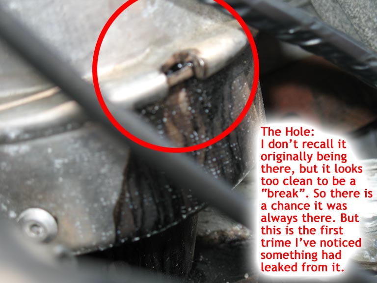

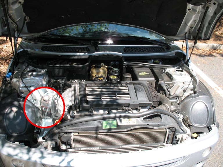

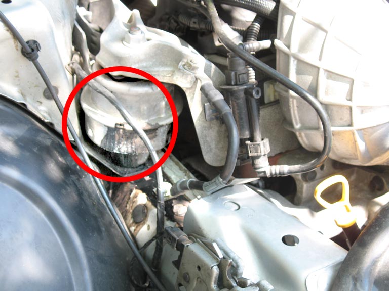

I noticed that something under my hood recently went leaky and I have no idea what it is or what caused it. Since I'm beyond my warranty, I was hoping you might be able to help me out. Any idea? thanks!

Engine Mount. Yours has failed and should be able to be replaced under warranty.

hydraulic vibration damper. have you noticed it idling a little rougher?

This is the motor mount engine damper and as you can see it is an oil based damper !
You should replace it quite fast... otherwise your engine-vibrations will get transfered to you chassis *brrrrrrrrrrrrrrrrrrrrrrrrrrrrrrrrrrrrrrr*

Here is mine. Although rubber, they are oil-filled. Got it replaced today while getting a WMS 15% pulley.
