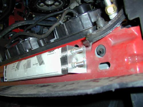

How did you get it off? Do you know of any "how-to's" on this? I am thinking of getting a small radiator and attaching it to the power steering line. This should keep the power steering unit from over heating.

getting it off was fairly easy (only came away with a few minor scrapes and skinned knuckles), there's about a million guides in forums all over the web, and most also suggest buying the euro haynes manual (which is pretty helpful).
the power steering line is a hard metal one, so i don't know if a radiator is a viable option, there is already a fan on it, and if you're having issues you might consider just upgrading that, or adding some sort of aero scoop to move more air to it.

I am thinking of installing a power steering cooler since I live in AZ where the temp under the hood feels like you can fry an egg. Before I go through the hassle of getting the pump out...etc.. has anyone heard of this, have any advice or think this might be a fruitless DIY trick?
This is the one I was thinking of getting....http://www.perma-cool.com/Catalog/Cat_page15.html
