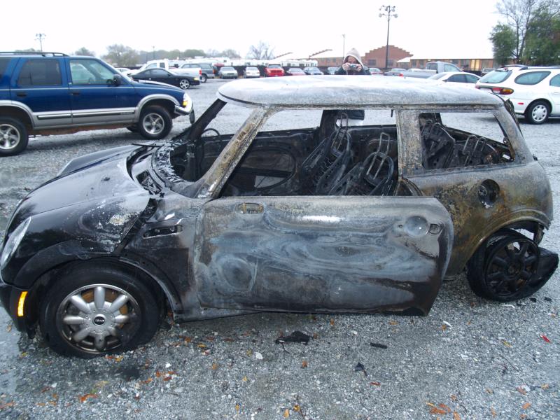

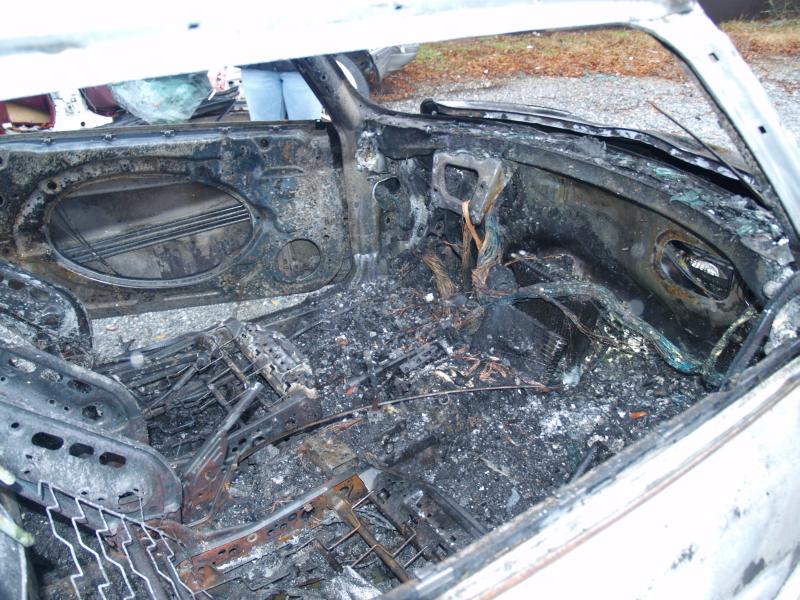

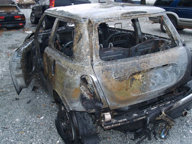

My 2002 Cooper Caught Fire While Driving
I found this site yesterday, 1 day after my Mini caught fire while I was driving it. I did a google search, and here I am. My story: I bought a 2002 Mini Cooper in 2005, with about 32000 miles on it. Fell in love quickly. Then, 2 days ago, I was 1/4 mile from my house, on the way to the grocery store, and I thought I heard a spark or something, and then there was smoke coming from the passenger side right under the dash. I somehow managed to pull over, pull the e-brake, undo my seatbelt, turn off the ignition, grab the keys, and then got out. Within seconds there were massive flames coming from the interior. Take a look at these pictures.
Attached Thumbnails Spontaneous engine bay fires!-021.jpg   Spontaneous engine bay fires!-027.jpg   Spontaneous engine bay fires!-024.jpg

OMG. I almost threw up looking at those pics. I'm really sorry for your loss. Just glad you made it out safely. Really interested in what might have started an interior fire of that magnitude... obviously some short or electrical failure under the dash or the BCM, but what I wonder?
