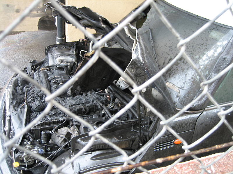

During:

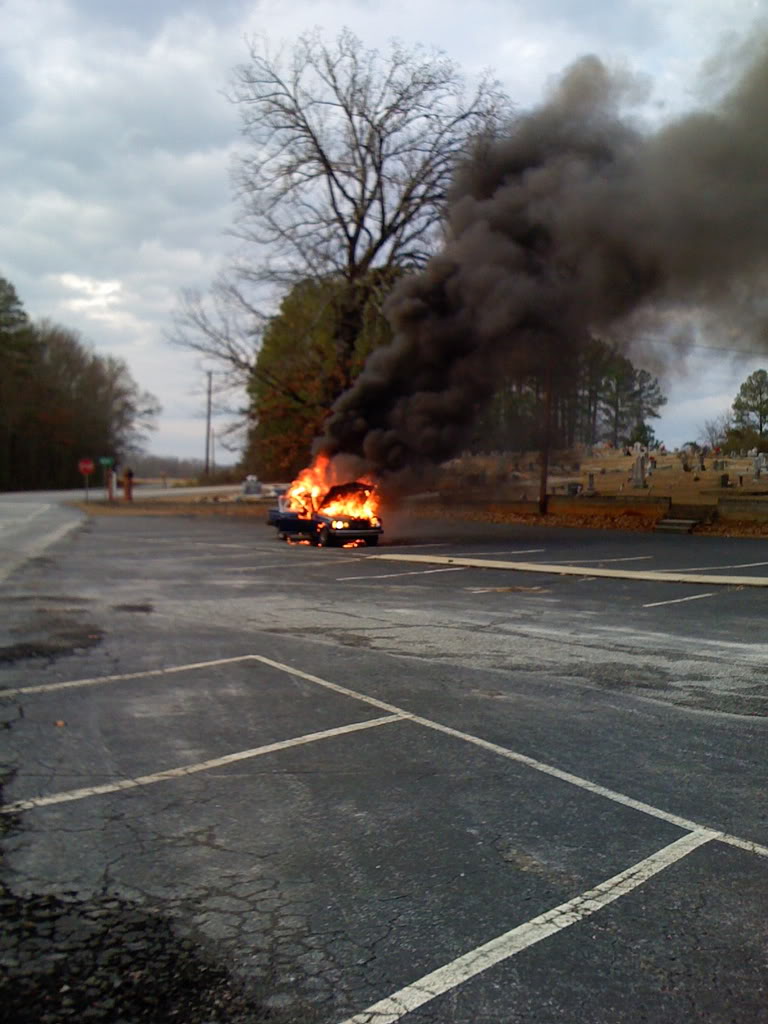

After:

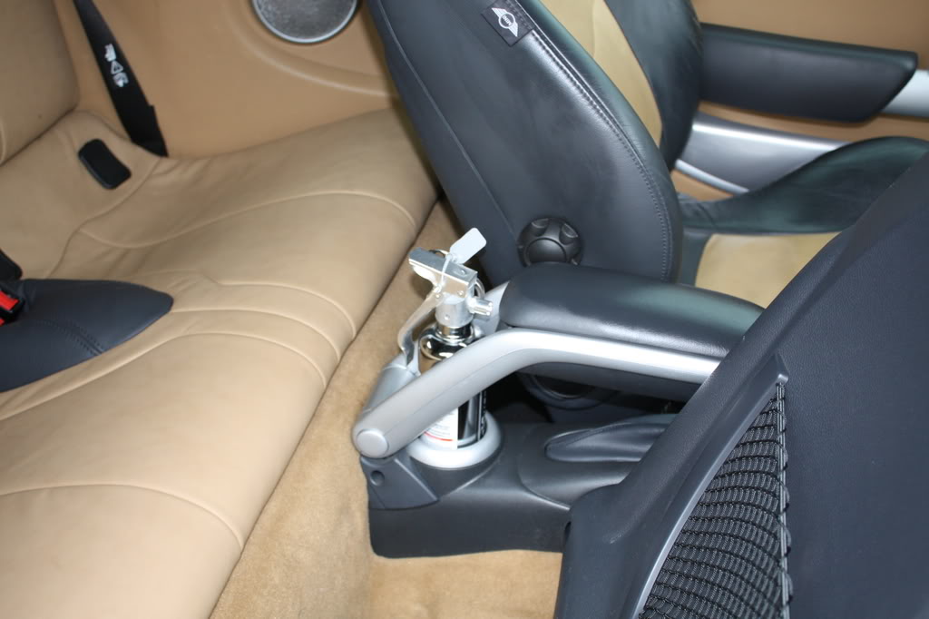

Well I can say this... the rear cup holder (the one just behind the arm rest) is a perfect fit and very good place to put one of these. I just got the one for the MCS today and was sort of searching for a place to mount it when the thought struck me. And so I took it off its mounting bracket and PRESTO! Fit and looks good too.
This one
This one I obtained from Summit but here is the specs on it. Good computer safe, residue free one. Comes in Red or Chrome but Chrome looks good in the cabin.
http://www.h3rperformance.com/hg100c.htm
I know this is worthless without pictures but it was too dark to take a good one. I'll get one up tomorrow for ya. Looks great really.
By the way... most sellers of this one list it as 1 pound of ingredient. The manufacturer says it is a 1.4 pounds.

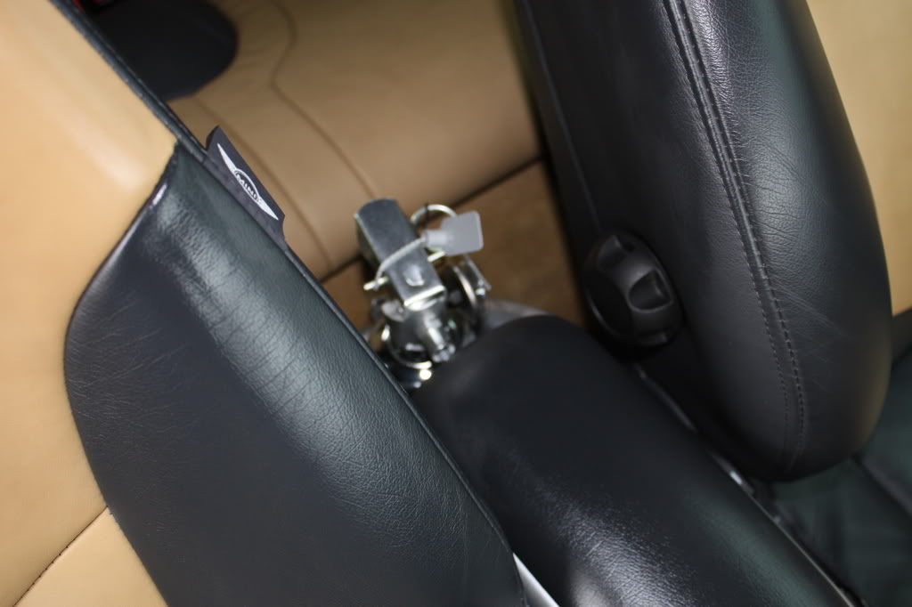

Well the chrome one is $25 more than the Red one but, in this instance where it will show, I think its worth it. And its at the ready this way.
It does come with a mounting bracket and holder and there are a couple of real nice Billet Aluminum mounting solutions too. But this one works pretty well. Note you cannot raise the arm rest all the way back with it in there though. But I rarely do.
Here are a few pictures of it in the back cup holder.

Hey guys,
Just came across this thread this morning and thought I'd add a data point. I don't own a Mini, but this morning my dog was very insistent on gettng me out of bed and outside in the morning. Upon getting out of the apartment, I noticed a burning smell. It was raining (according to the weather reports the worst rain we've had this year in L.A.) and my neighbor's Mini, which she parks about 5 feet from my house was totally engulfed. It was parked under the overhang of her apartment building and the flames were just starting to reach the overhang. Someone had just called the fire department and the showed up a few minutes later.
According to the fire department, we were about 3-5 minutes away from catching the neighor's house on fire and my house shortly after that.
