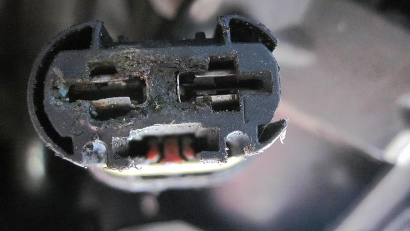

Possible cause of fires????
My power steering has been intermittent lately. After reading posts about the power steering pump failure, I decided it was time to take action. Rather than order a new pump I decided to check electrical connections first. I found that the connection for the pump power was the problem. I will try to post the picture of the wiring for the car. The harness showed signs of shorting, however I never had a fuse blow. I hope this helps with fires and power steering problems for someone.

Wow, smart move! Looks like the next logical step would be a fire from that corroded plug. Mini actually had a class action suit against them recently. You might want to look into it

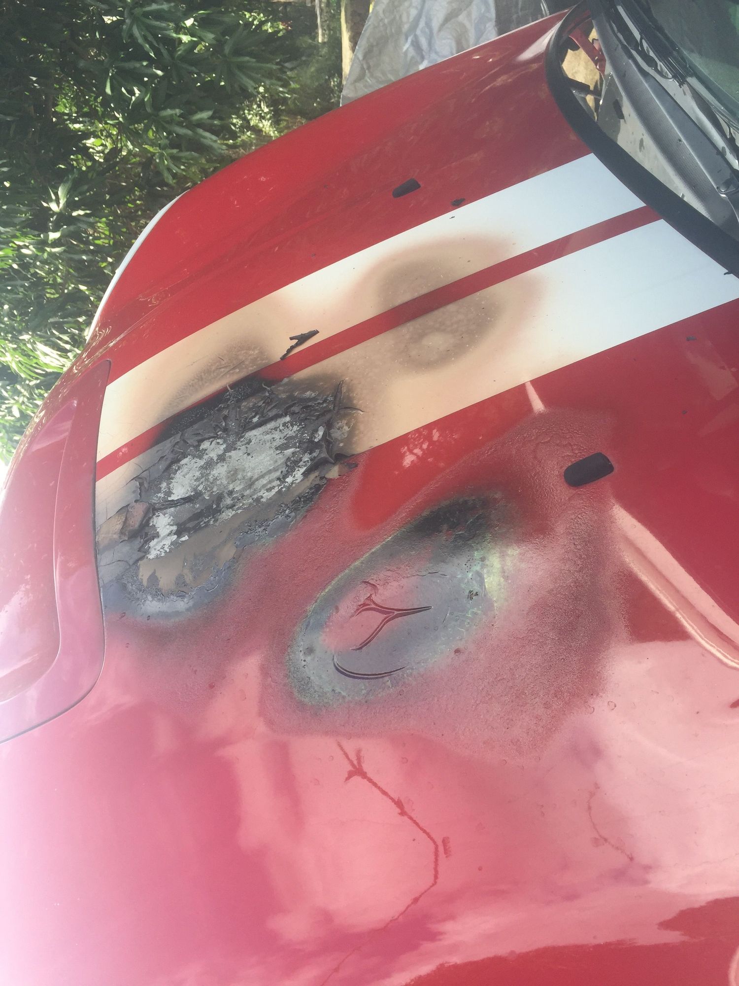

Long time no see guys! Well I hate to be in this thread, but my 2011 r56 caught fire after being parked after a normal drive (on Christmas Day). Luckily I saw it and got it out out with a garden hose before it lit my house on fire! It's been a frustrating so far with low ball offers from insurance since it is a total loss. I've filed a claim with the national road and safety link on the first page here and in contact with MINI/ BMW for an investigation. What has been some of the outcomes from MINI on this. My car didn't have an open recall but seems to be identical to the water pump recall that caught so many cars on fire... sorry I didn't read through this whole thread I'm sure my question is answered somewhere.

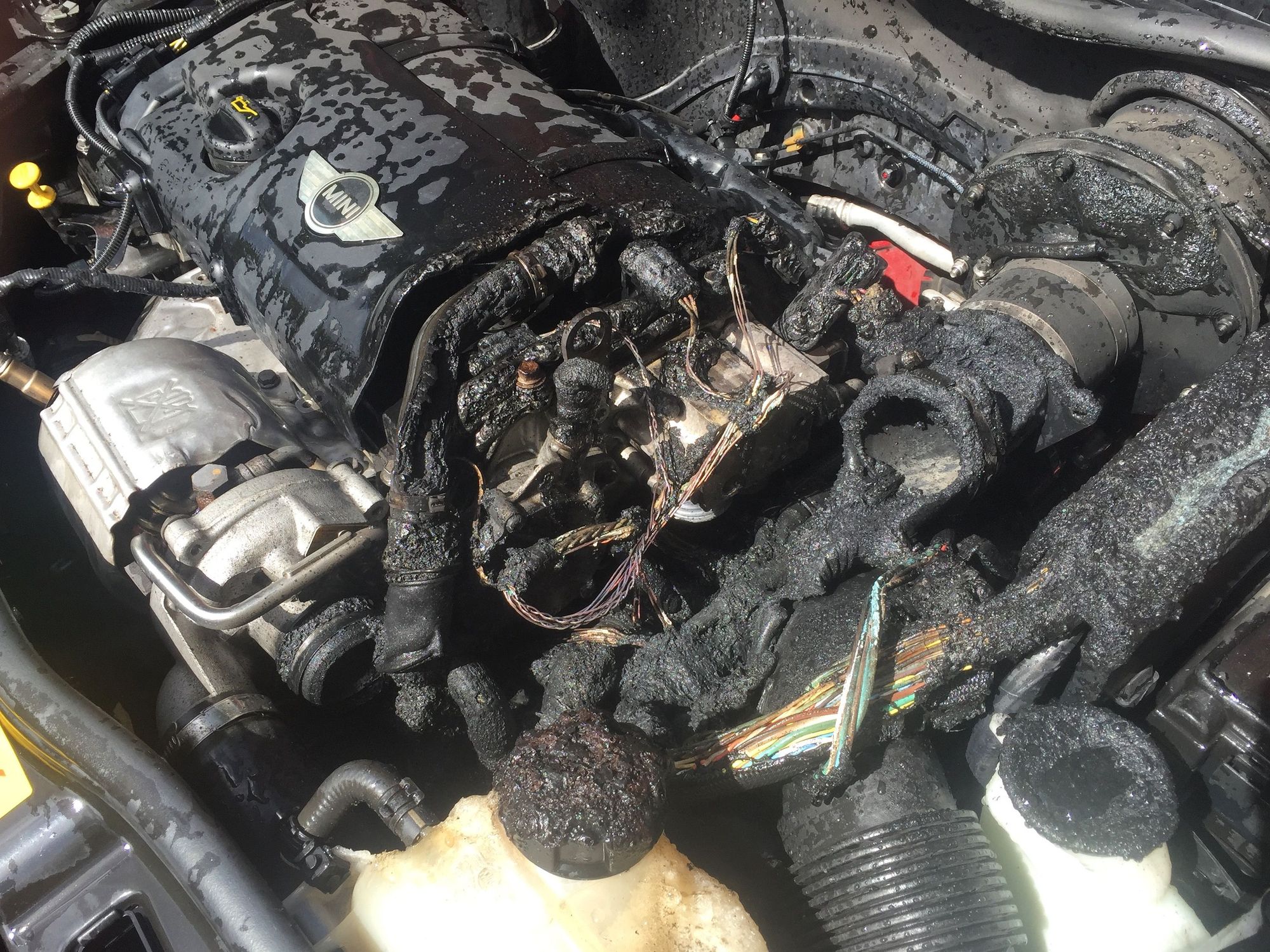

Add me to the list. Lost my 2006 MCS last Monday. Running perfectly driving 65 MPH then I heard a “pop”. Engine cut out, all the dash lights lit up and I lost my brakes (used the emergency brake to stop the car on the shoulder of a busy highway). Guy pulls in behind me, I poke my head out of the door and he yells “GET OUT OF YOUR CAR!”. I grabbed my work bag, jacket and iPhone and stepped out of the car for the very last time. I closed the door and flames came over the hood. It’s either the power steering pump or the ABS brake module. My money is on the power steering pump.

There was a recall that replaced the PS pump and the fan. It's sad, your car looked well cared for.

Wow, glad you are Ok and it did not involve any other vehicles.
My condolences on your loss, it looks like a clone of my HB 06 MCS :-(
I checked on the recall for mine and it did not fall under the PS Pump recall per the dealer.
Just replaced the PS hoses and at 147,000 miles now with the original PS pump.
Was your PS pump making any strange noises before it happened?
