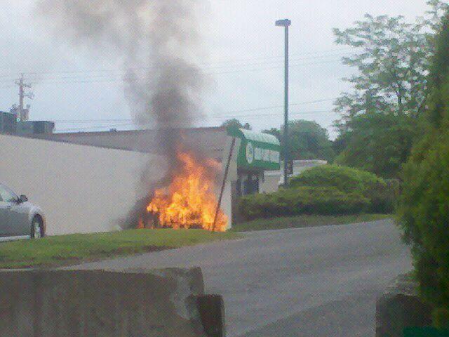

My wife sent me a pic of a Mini burning in the lot where she works. She owns a 2003 S, it wasn't her's on fire. I uploaded a pic.
I'll try to get more details.

Hard to tell, but it looks like Mellow Yellow to me. If so, it's got to be a 2nd Gen R56.
Looks like the wind is blowing in just the right (wrong) direction to stoke the blaze. Nasty.

It does look like an R56 - the squared off rear & wheels.... This is not a good sign

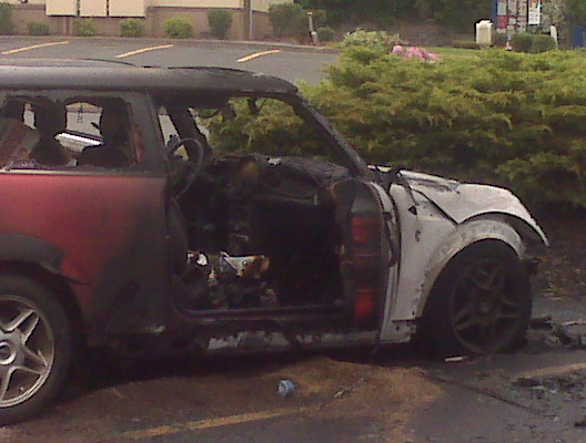

I am so sorry for you! I see that your's was red too. It is like losing a best friend. I am amazed that there have been no fatalities....at least not that we know of... My insurance company and BMW will be inspecting my car at the salvage yard tomorrow. Will be sure to post the results. Mine was still under warranty. I wonder what that means!??
I am really glad that your car is under complete investigation.

Attached Thumbnails Spontaneous engine bay fires!-mimi-fire-1.jpg   Spontaneous engine bay fires!-mimi-fire-4.jpg   Spontaneous engine bay fires!-mimi-fire-5.jpg
