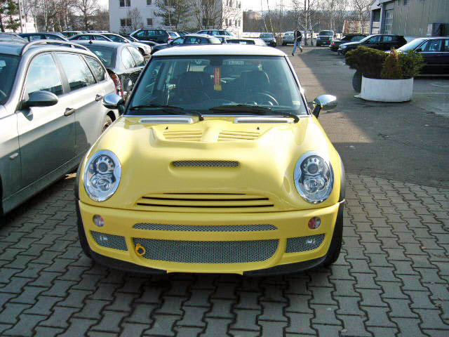

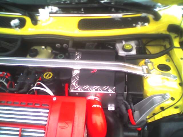

Good idea. I think there are alot of us that have altered the Alta air intake box trying to getting the same sound and performance but with the added safety of having the cover. Here is my modification as I have to have an open ventted hood made here in germany.
Attached Thumbnails Cutsom CAI Box project-pic002_27nov05.jpg   Cutsom CAI Box project-p1030401_edited.jpg
