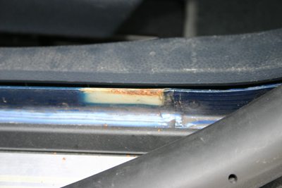

I hate to join this club but I'm in
Driver's side has more than passenger's, but in both case still wet even though I washed the car more than two weeks ago.
I will call the dealer (Bob Smith in Calabasas CA), send them the pictures and a link to this thread and let you know what they say.

---> Moist carpet??
Are you guys finding any moisture in the carpet right below the weather-stripping as well as around the foot-rest pedal??
I just got back from washing my car, and of course, peeling off the weather-strip to dry the rocker seams, I removed the shoe mats and noticed some moisture along those areas....not sure what’s going on.

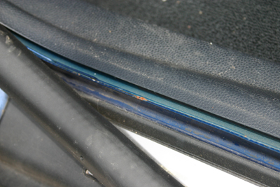

when you post pics of the rust
could you back up a little bit, maybe a broader shot of the whole door area, then zoom in on the rust accordingly? I'm having a hard time getting some kind of perspective here as to where on the "door sill." Thanks Jimbo

Just for comparison, thought I'd also report on the rust on my 2005 Scion xBox. Also located on the door welds, but not associated with moist areas under weatherstripping; just sloppy spot welds at the joints. The rep said to bring it in to any Toyota or Scion dealer, let them know the problem was documented to Scion over the phone, and they will take care of it under warranty. We'll see if that actually happens. In the meantime, the silence from MINI grows more deafening by the day.
Had the MINI out today and found that the area was dry this morning but had water after it rained. The car was not driven in the rain, it was just parked. That proves that the water is coming from above, not being kicked up from below during driving. Roof to A pillar to door sill is the most obvious path, with the weatherstripping sealing in that moisture for days or weeks after.

Listen, I understand it's only surface rust. I think everybody has a problem with the cause of that surface rust, which may be a problem with a sill or something else....that's what we're trying to find out, that's all.
The cause is water trapped under the weatherstrip, thats a no brainer.
MINI wont do a damn thing about it because right now, theres no threat of damage other than surface rust.
Bust asking for MINI to come out and relase some kind of statement about surface rust under weatherstripping (not that you said it, but it was on another page) is extreme.
I could see a service bulletin with perhaps a revised or redesigned weatherstrip, but right now, this isnt a big enough issue for MINI to deal with, they have more important thing to do than mess around with something that wont be a big deal for at least a few more years. Right now this is minor enough to catch before it does get to be any worse. But until it gets to the next stage of worse than surface rust, MINI wont help out.
