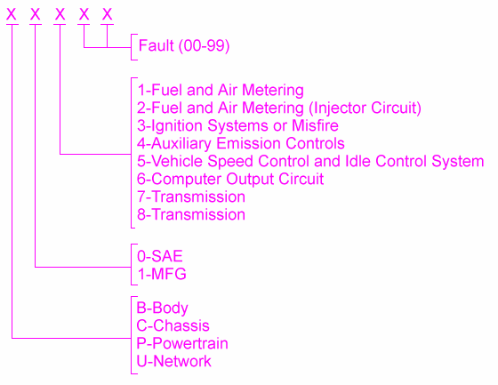

You may be able to borrow with a deposit, or rent a obd-2 reader from an autoparts store... I can do that in California auto part stores. (you can buy them for between 70 and 100 USD) It won't tell you BMW specific stuff that the two devices the dealership have, but it should tell you error codes that could be causing the light to be lite...
the attached graphic can help understand the obd2 code... others know more than me, but this is a start...
Good Luck...
