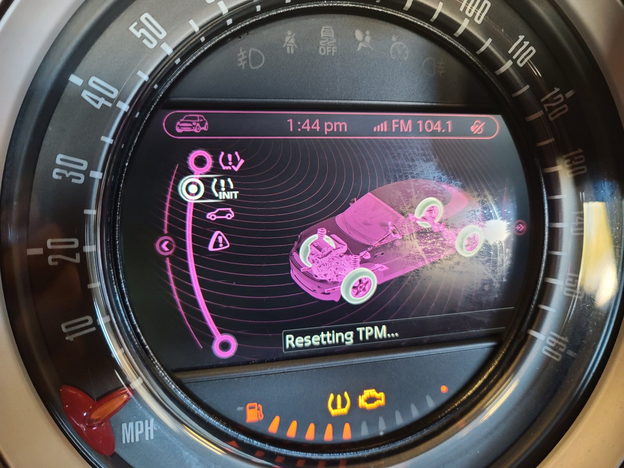

So I can't get my tpms light to turn off.. before I had my new rims , tires and tpms installed it would occasionally bunk out and have to reset but since the new 3x were done , it will not complete the learning process and says FAILED after 10min of driving.
1st after I installed the 3x I couldn't reset and go onto relearn mode so I did some research and though the fuse didn't look bad , it was so I replaced that and now it atleast tries to relearn. I ALSO tried a junkyard tpms module ( sits in rear bumper ) amd it was the exact part numbers and everything but that had no change..
I inflated the tires to 42psi for the relearn and i did like 5min city driving and then 5min freeway driving but it continues to say FAILED.

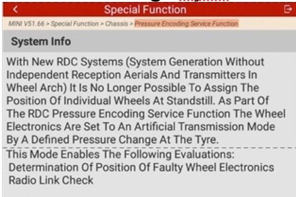

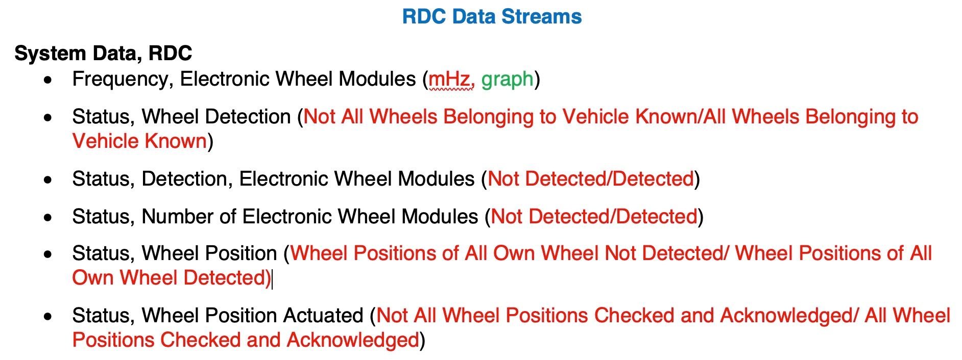

Have you used your scan tool to run the Tire Pressure Encoding Service Function and to check whether all four wheel sensors are communicating with the TPMS module?

If you're have a TPMS warning light that is not cleared by the normal TPMS reset procedure, reading live data from the wheel sensors and running the Tire Pressure Encoding Service Function using a scan tool are the next logical steps.
It costs much more money constantly replacing parts that are good than it is to buy a good scan tool.

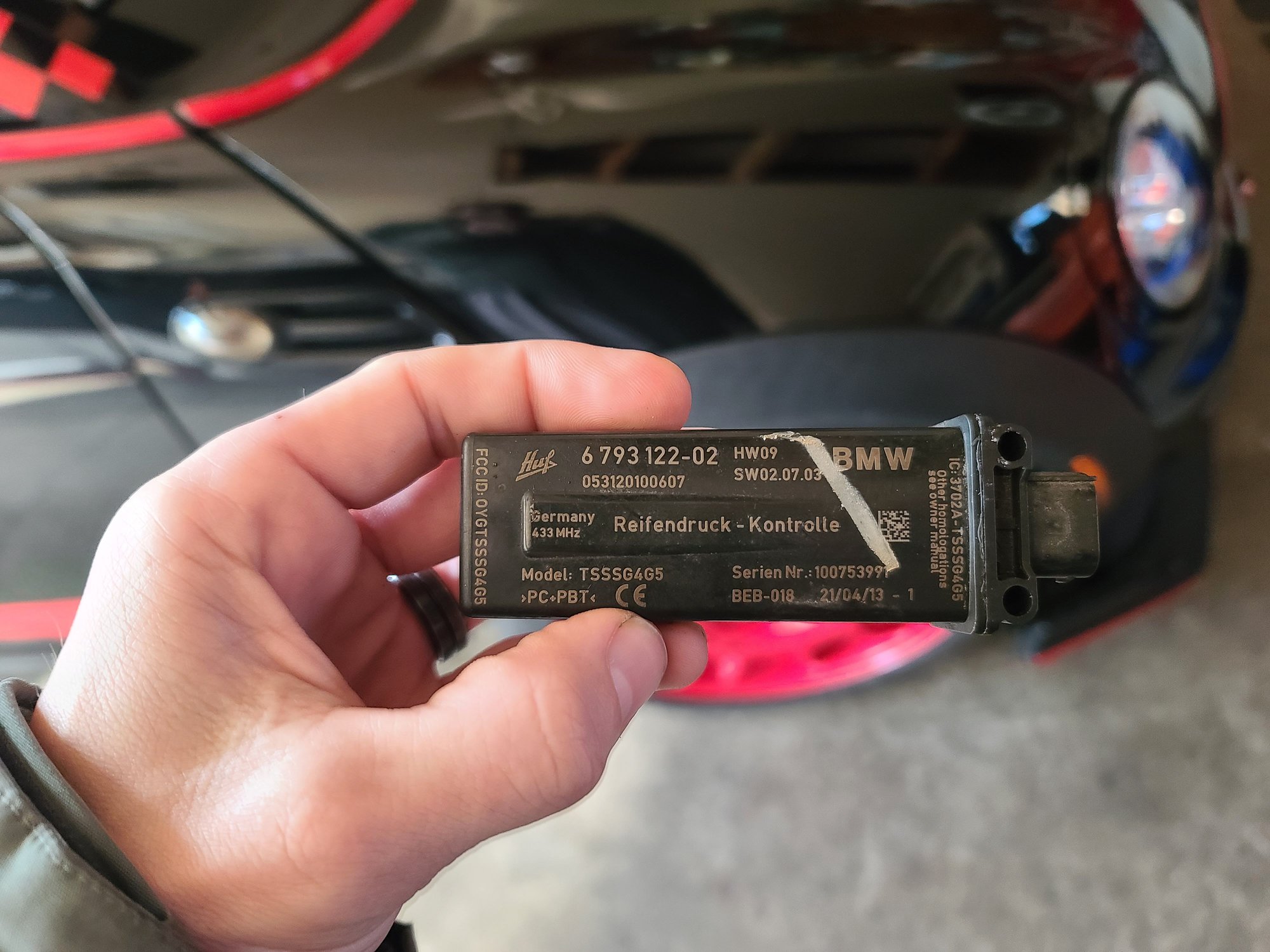

If anyone runs into this and needs to replace the antenna also. My r58 amd turbo r56's the antenna is located ontop of the rear ceashbar behind the bumper , remove the 2x screws and pry the bumper back and you can pop off the antenna and pull it down via the wires into the passenger side wheelwell without removing the tire or jacking it up..it is the Long skinny shaped one pictured.
