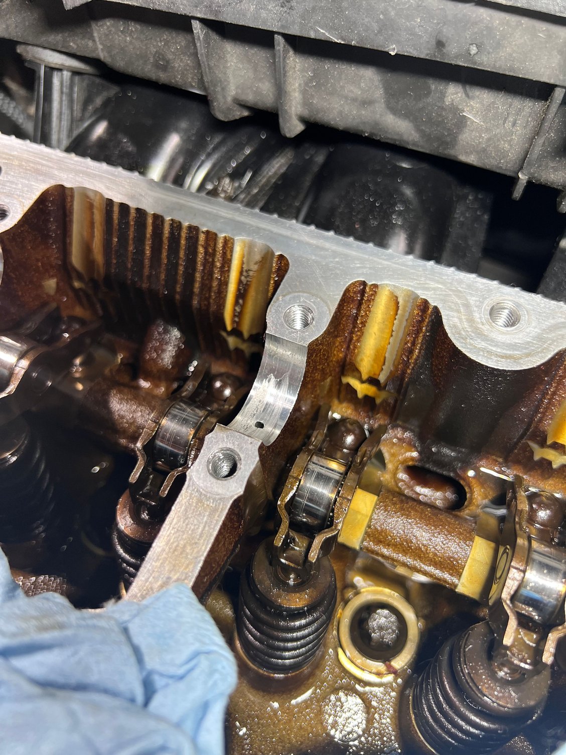

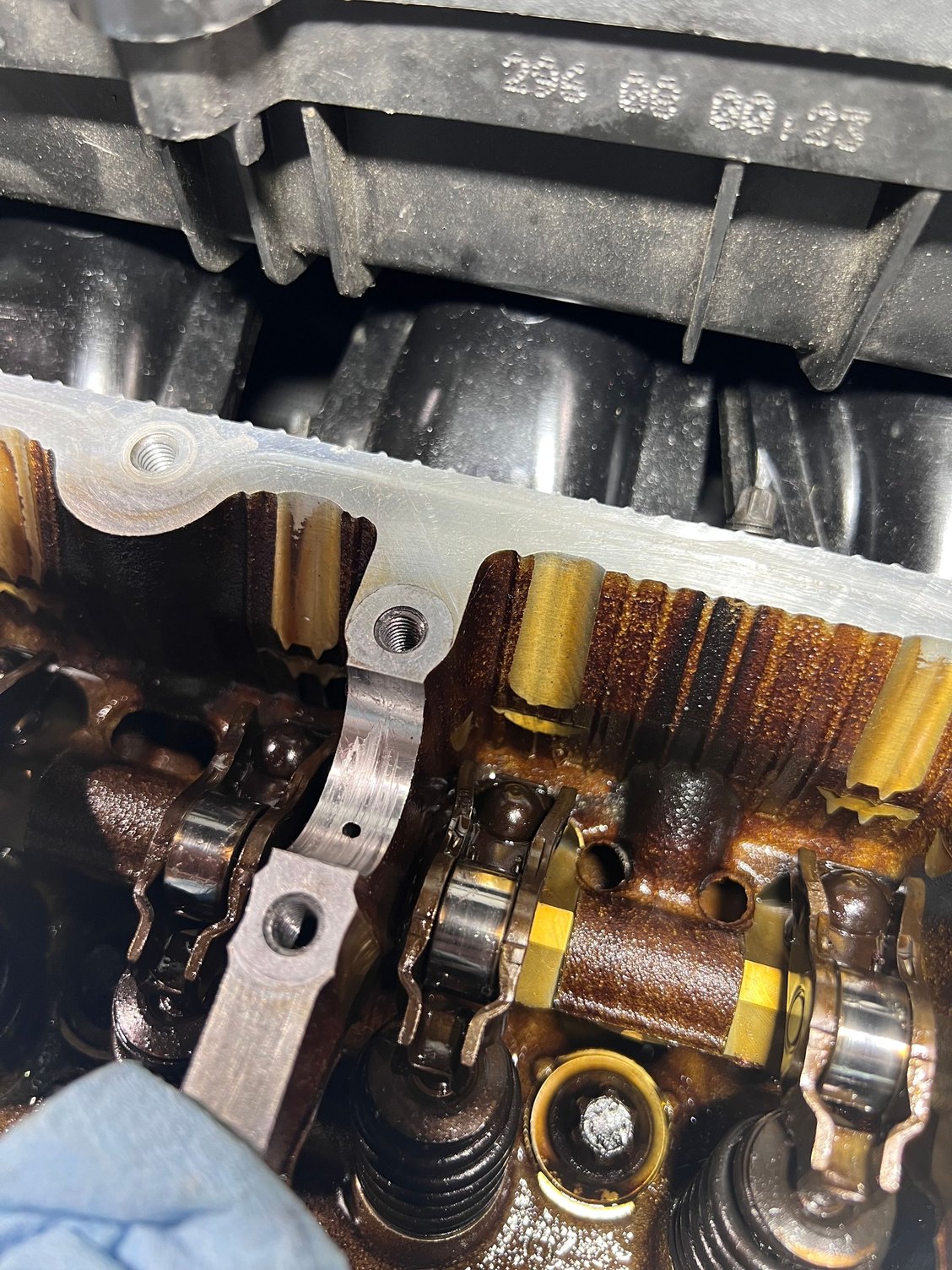

Got everything back together earlier in the week. Crank, no start. Pulled the valve cover to see the timing had jumped. Got around to taking things apart to do the timing only to find 7 and 8 cam journals, caps and camshaft scored. I snapped two of the cap bolts when I had everything apart previously and there were shavings left over.

Unfortunate outcome. What's the plan moving forward?

Going to pull the head and call a machine shop. At least get an idea if it can be fixed and how much. Otherwise it's remanufactured head

Expensive mistake. Thise cam caps are line bored, and when removed, need to go back where they were removed.
You “Could” rebuild the engine… I’d be willing to bet that not everything is trashed, and you could get a decent build out of it.

I don't have the expertise, or access to the equipment needed to do a proper rebuild. Calling the engine rebuild shops netted me quotes more than getting a quality used engine, new turbo and labor to have a shop replace the engine. I don't have the space for a project car either to slowly rebuild an engine and learn as I go.
