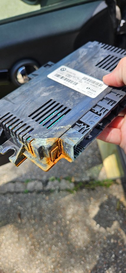

Well, decided to pull the FRM & see if disconnecting it, then plugging it back in would do anything.
Best guess, when the A-pillar trim was missing, water was getting inside & settling at the bottom of the FRM cavity...
The lower connector is a little corroded looking, but not as bad as the FRM box is...
Is replacing the FRM even a viable option, with what's shown above?

Try disassembling the FRM to allow inspection of the circuit board and connector pins.
Are any of the 4 FRM fuses blown in the passenger footwell fuse box? You may want to look for similar water damage there too.
Also drive to the MINI dealership to see if the FRM water damage is covered by the recall.

I did pull the FRM box apart, a little corrosion on that bottom corner, but not as bad looking as the box exterior. No idea how long it was wet, the car sat for a year before I got it.
I'd rather put a few hundred into fixing this, than try to find another cheap commuter. More concerned about the residue/corrosion on the plug on the car side.

I did pull the FRM box apart, a little corrosion on that bottom corner...
​​​​​​​Post some pictures.

Well, it was worth a shot.
I'm out about $12 for some contact cleaner & a nylon brush. Cleaned it up best i could, no change.
Before
After

What's the condition of the FRM connectors on the car side?
Are the 4 FRM fuses intact and getting voltage?
Old Jun 16, 2025 | 04:33 PM
JAMADOR's Avatar
JAMADOR
Joined: Mar 2024
Posts: 372
Likes: 72
From: Houston, TX
Post #8 above. The lower, forward connector was a little green. Cleaned it up as well & hit with some compressed air to blow out any lingering stuff in the ports.

You need to replace the bad corroded FRM connector and check the FRM fuses before condemning the FRM. But the FRM definitely looks to be in bad shape.
