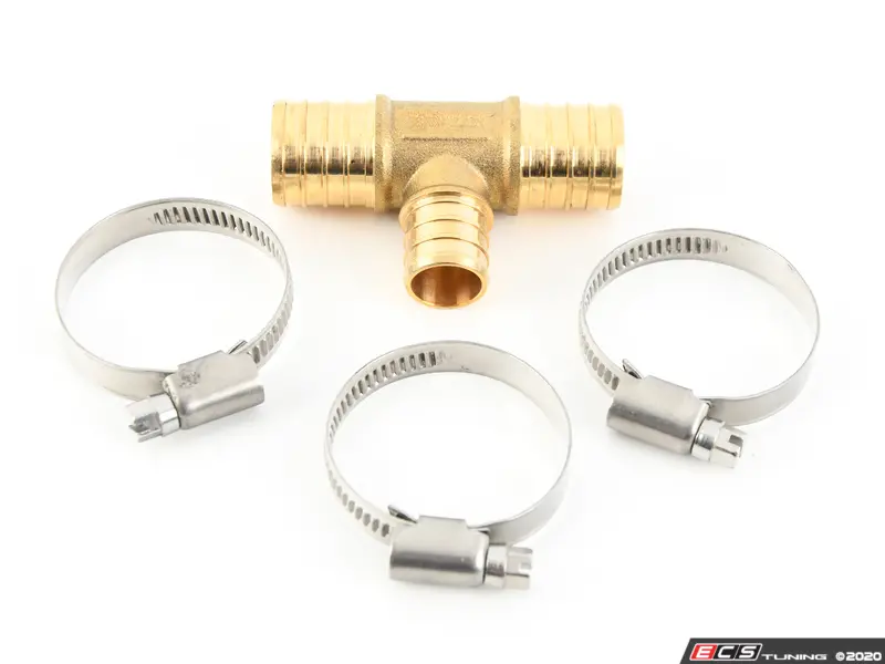

I actually went ahead and order parts from you overnight. Just replace coolant tank and hoses (both the one you're showing and the one between the tank and that). I ordered the hose with the metal T. Was a little confused by the dimensions at first but it fits.

Also, while I like the T metal connector I got, BMW MINI clamps are way smarter. They come open with a release clip. Makes the install really easy. An obvious design choice to reduce labor time for their service.
