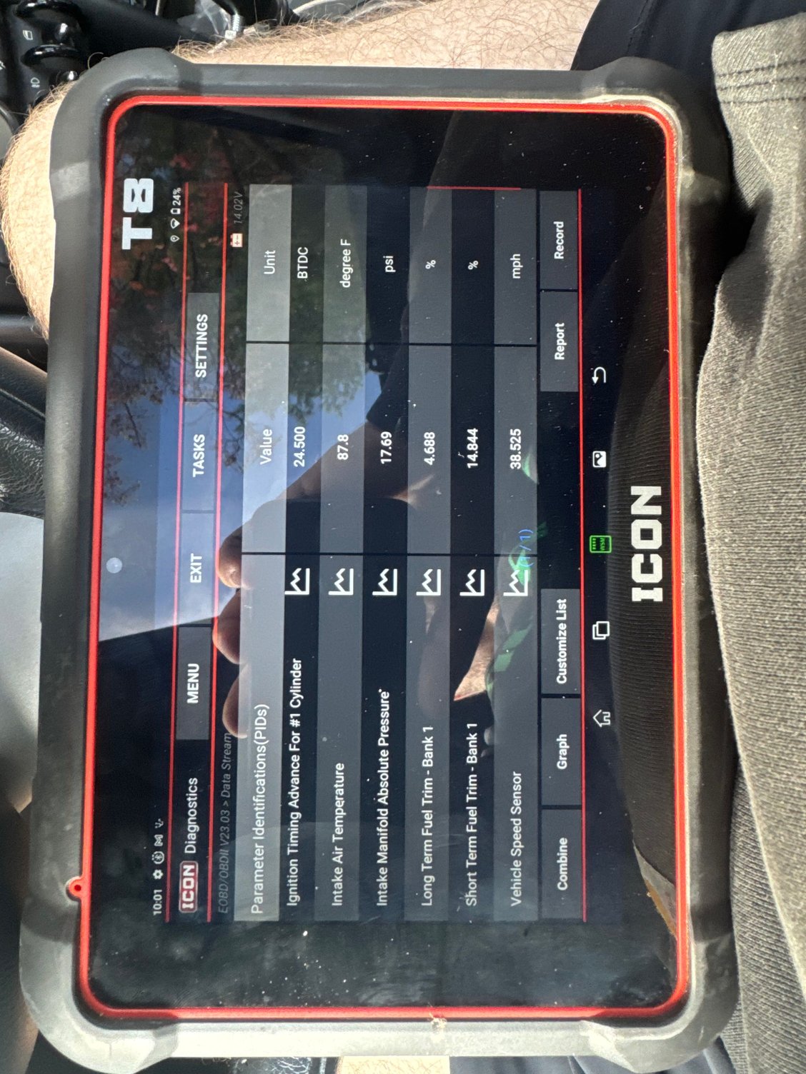

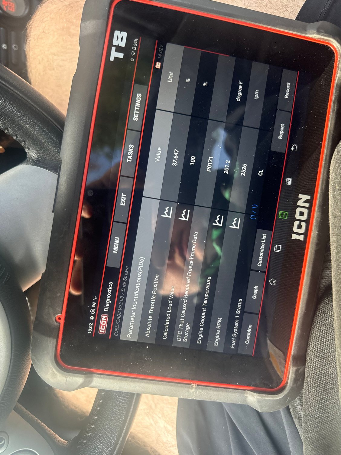

I recently replaced my clutch because it was slipping and now when the car gets warm it’ll start to miss fire I have a p0171 system too lean bank 1 as the car get warmer the lower and lower the rpm’s will let me go into 4K, 3k 2k. The question is has anyone else experienced this
