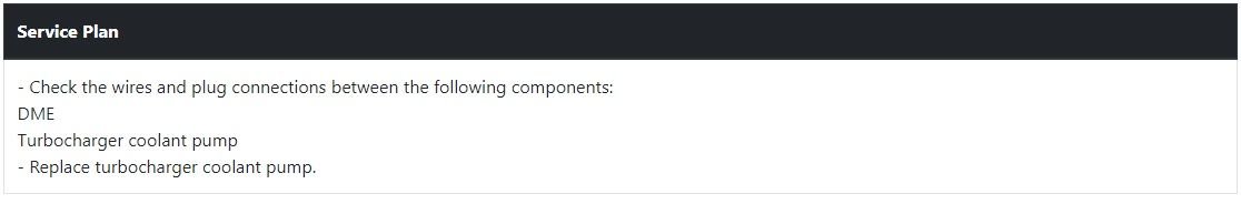

I can't answer most of your questions but, it you look up the codes on https://bmwfault.codes/ If you click on the hyperlink to the right of the code, most of the time it gives you some of troubleshooting for the code.
The below image is what you get when entering 3786
