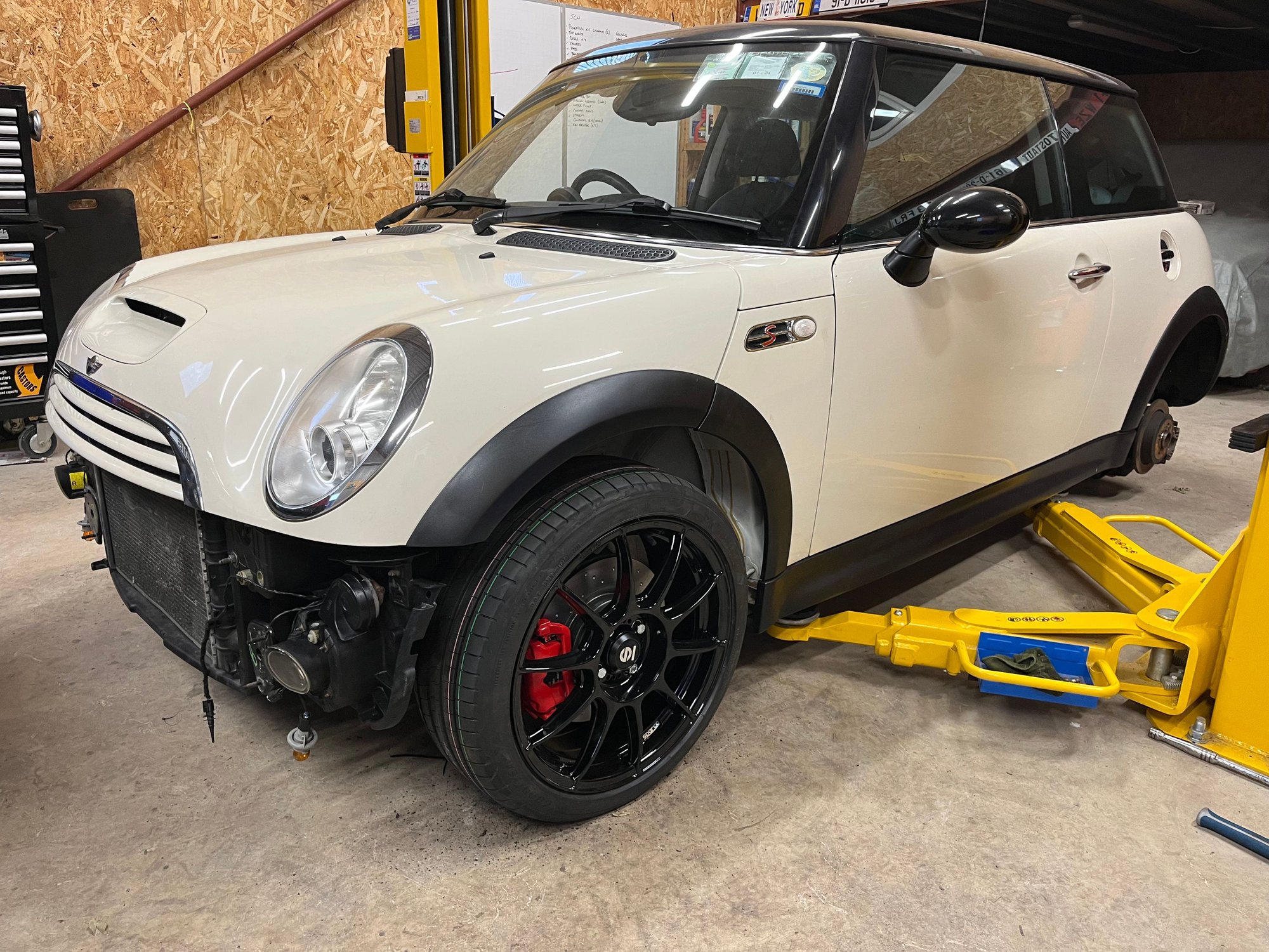

Hi all,
I have an R53 that I have just fitted refurbished R56 front calipers to, new pistons and seals, rear calipers have new pistons and seals.
All rotors and pads are new.
I’ve tried pressure bleeding the system, got lots of air out but I can’t seem to get a solid pedal.
I don’t have a diag too to trigger the abs module, is there any other way to sort this?
Thanks.
