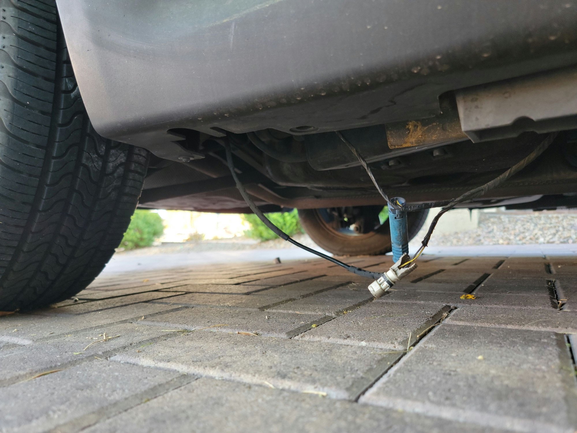

Also, a dangling connector on the passenger side behind and under the door. Any identification there?

The dangling cable under the car is either the break pad sensor or the ABS sensor, or both. Both important though it is possible the previous owner was tired of replacing the break pad sensor (due to cost) and disabled the sensor by connecting the wires forward (maybe by the fuse box?).

And yes, the wires underneath I conformconfirmed were pad wear sensor wires.
