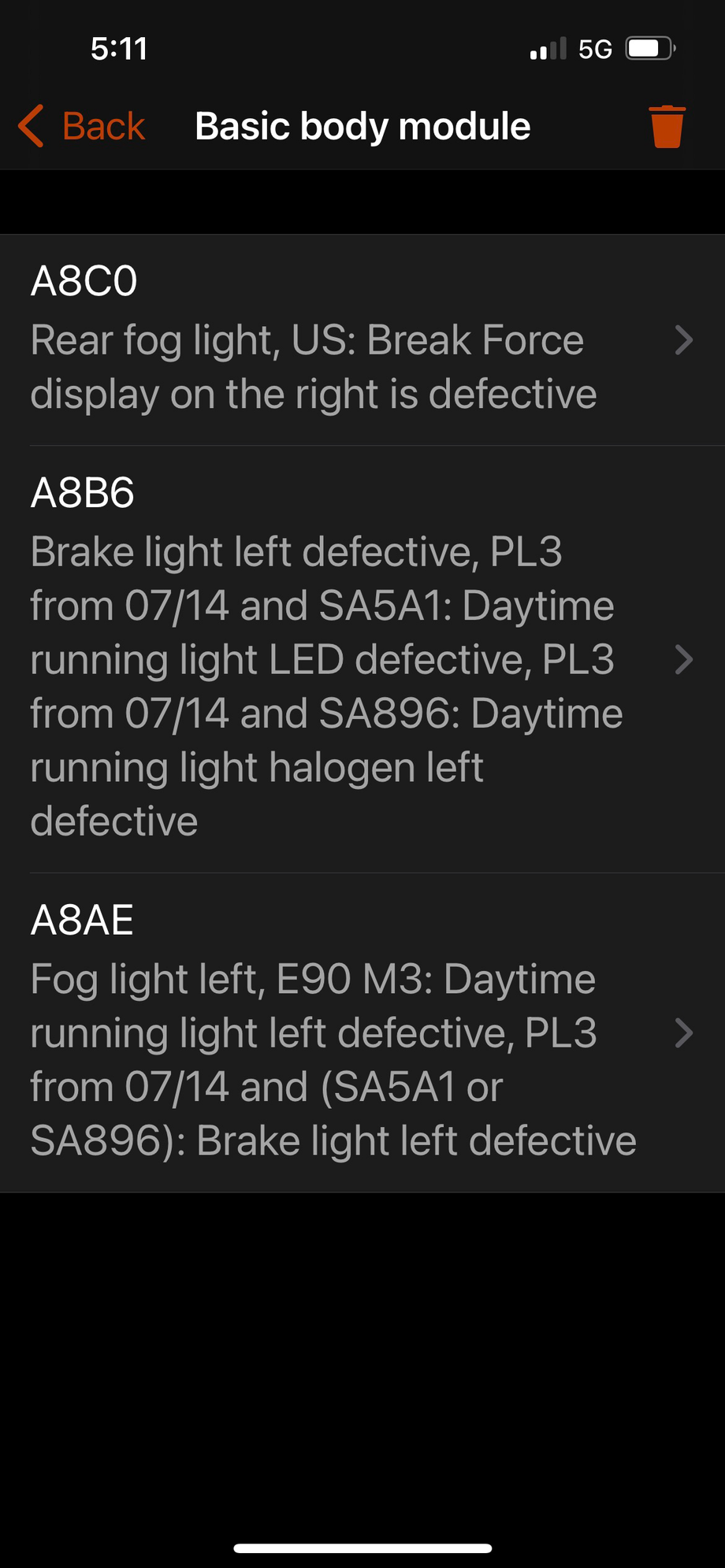

  3. Other codes: I'm also becoming more convinced that the A8AE and E72C are coming from the foot control module that the dealer has to reprogram specific to your car. Getting different codes there today. This is probably solely on me as I forgot to disconnect the battery when I replaced the crossover water pipe. Screenshots below.

Also still getting weird codes about fog lights, side lights, low beams, etc., but all of those are functioning as normal. Also, the driver's side window drops about 3/8" and stays there when I turn the car off and get out. Rolls up fine when I get back in, start the car and flip the raise window switch. I'm still leaning on needing to get the foot control module reprogrammed to clear these codes/issues. Is bimmercode or some other software/app capable of doing this DIY? I haven't studied up on any of that, but suspect it's best left to the pros.
