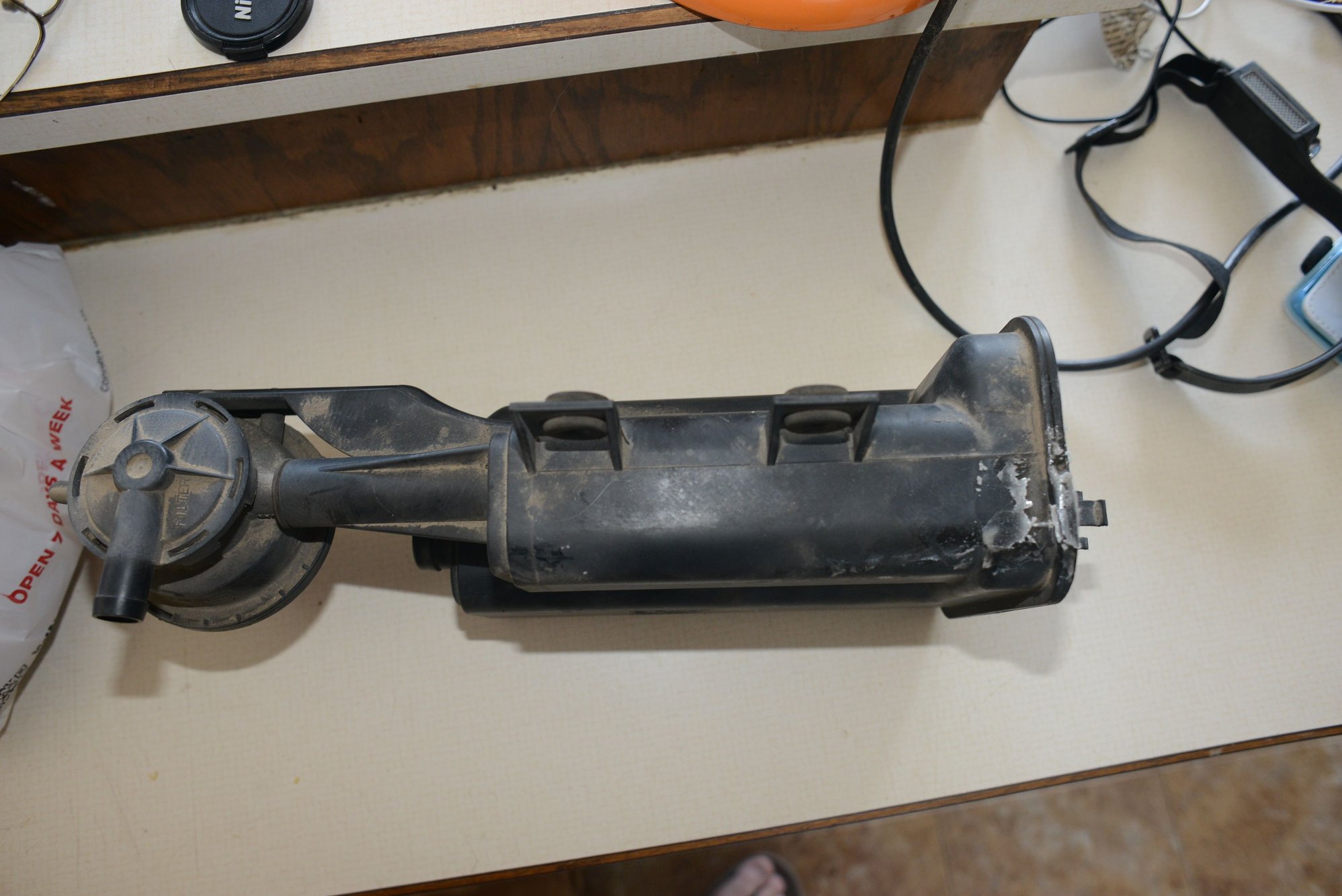

Been smoke testing the evap system on the wife's r53 because of a P0455 code, and have it narrowed down to the charcoal canister filter. Filter itself looks like it's in pretty good shape, but it has a small crack on the upper part of the front right at a seam. I can't get the filter down because of the way it's bolted in - looks like you have to drop the fuel tank maybe to get to the bolts. For now, I mixed up some high adhesion plastic epoxy, cleaned the areas as well as I can and spread a layer of epoxy on there. I then put a small piece of gorrila duct tape over the area with a bit more of the epoxy and really plastered it to the seam. That should have the leak solved temporarily. Wondering if anyone ever had to do a replacement on the charcoal filter. Not much in the forums on this, and no one that i've seen in the r53 forums has fessed up to having had this part replaced. Wondering if anyone has and not posted about it?

The charcoal filter assembly in the 2006 is not in an easy to get to location and is not easy to remove. Rear fender liner and passenger side undercarriage wind deflector thingy need to come off - that is the easy part. The charcoal filter is attached with two hex bolts from the bottom (the not so hard part) and two pinch type connectors hung from the top of the fuel tank. These are the type of push through plastic and rubber cone-shaped pinch connector that are pretty easy to push on, but tough to get off. I ended up finally getting them to pop off with a long pry bar from the back side and quite some number of individual expletives. Oh, and there is very little space to get your hands in and around the area.
Top side. You can see a bit of leftover epoxy from where I tried unsuccessfully to plug up the leak.
... and here is why the epoxy repair didn't take. See that seam by my finger that is supposed to be welded internally? Yeah, well, it's not. Smoke pours out the entire length of that upper seam. I thought about mixing up some more epoxy and opening the seam up with a screwdriver and just pouring epoxy in there, but then there is the possibility of failure again and then having to do more swearing to get the damn thing out a second time. Found the part (16126766392) cheapest at BMW parts of south Atlanta for $200 shipped.
I know a LOT of people have had the P0455 and P0456 codes and the intermittent gas cap light on this forum, and in addition to checking the connection to the fuel pressure regulator, the seal around the fuel tank filler, and the plastic lines from the engine compartment fuel vapor solenoid back to the charcoal filter (much of which cannot be seen), this is another potential point of failure to check for. When the new canister comes, I'll switch the evap diagnostic pump on the canister over to the new one, and this should be the end of our P0455 - no smoke from anywhere else. Hope this helps someone else out!

I'm sorry that happened to be the cause -
Yes, you are right. There is little to no information out there from those having to replace that canister.
I also experienced that code as well as the SES light coming on every so often after reset. This began/was just after I had installed my 15% SC pulley
The error code and what I had read, indicated and led me to believe that the charcoal canister (as shown) was the culprit.
I was terrified when I learned of it's location and had nightmares about having to remove and replace it.
As dumb luck would have it - (in my case) It wasn't the canister afterall. I had inadvertently re-connected the EVAP canister (the one next to the right side SC horn), upsidedown.
Let us know how it goes.
