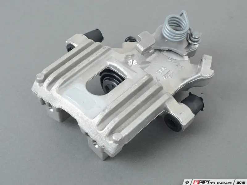

Here are the cables and you can lube them, for example on the Gen 1 MINIs
https://www.northamericanmotoring.co...ake-lever.html
https://www.northamericanmotoring.co...more-http.html
My caliper seized and i got new ones, the MINI life of a almost 300K car. The ohio salt kills them. 34216763729 34216763730 We just landed the 4/2003+ in bemmen parts. I did one side and then down the road the other one went. Got new and all better. Most of the time you can reuse the carrier.
On the gen 2 R56 ( your MINI ) we are seeing the same thing. Cables need replaced and the calipers. You can lube them under the boots to buy some time.
https://www.ecstuning.com/Search/SiteSearch/3440676995/
Rear calipers: https://www.ecstuning.com/Search/Sit...h/34216785611/
https://www.ecstuning.com/Search/Sit...h/34216785612/
