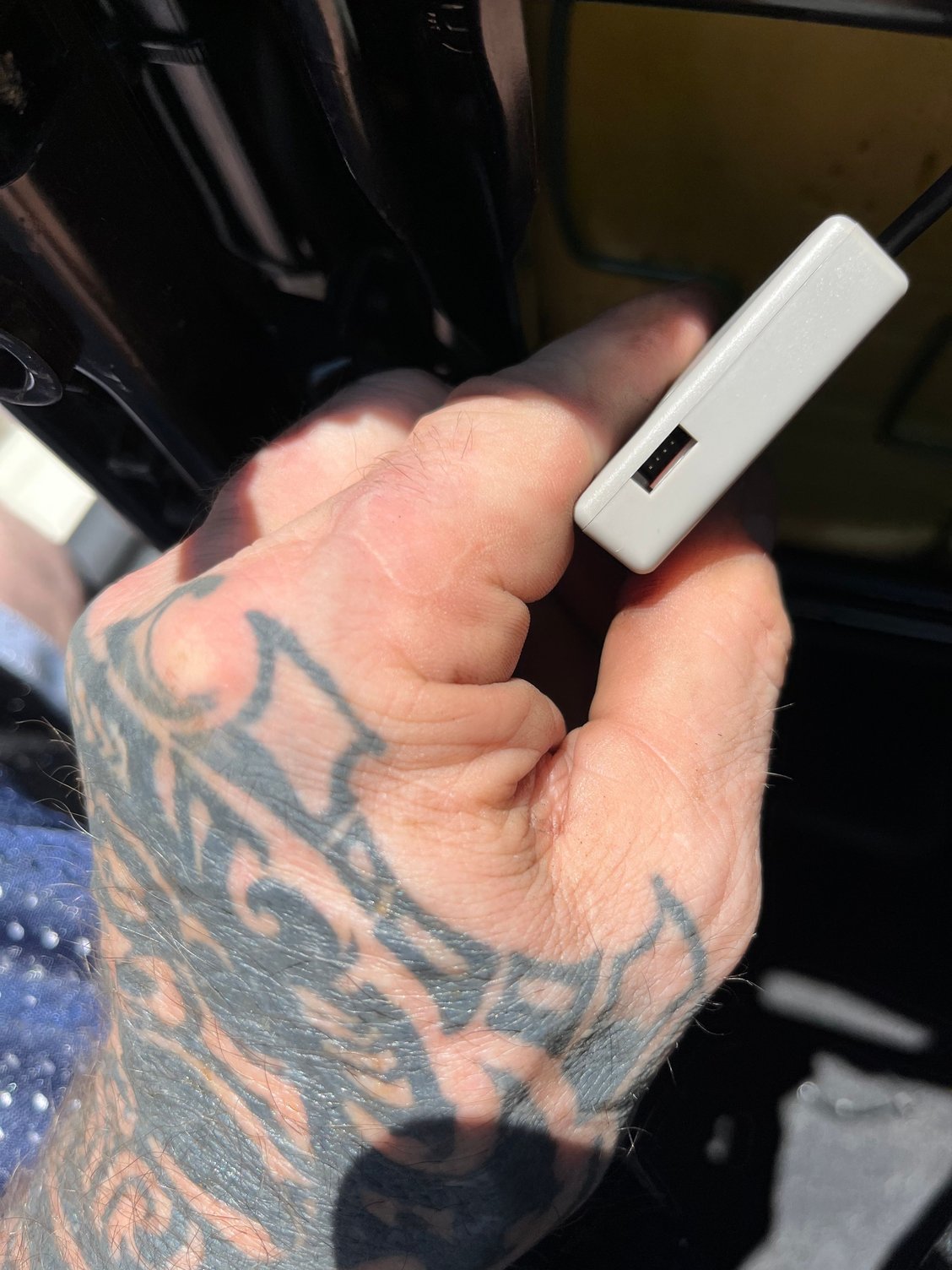

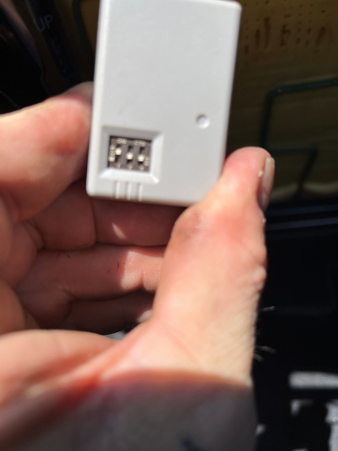

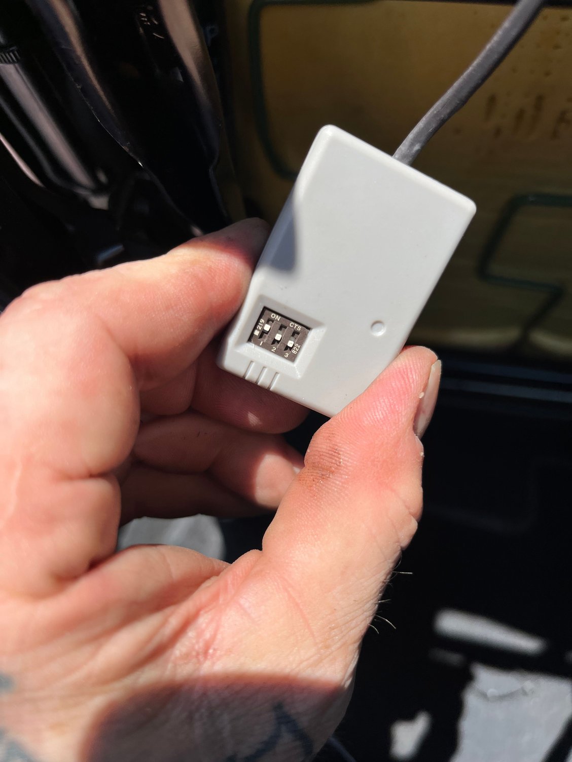

Does anyone know what this little box is?
I pulled the passenger seat again and noticed that this little gray box was just hanging.
So I traced it to the harness for the seat. I also noticed that there was a tiny square that had the same color two wires as the gray box that wasn’t attached to anything.
I disconnect the gray box and connected the tiny connector to what the gray box was plugged into and put the seat back. I took the car for a drive with the seat belt not clipped and the airbag light and chime didn’t come on.
im really confused on what the gray box is as it is not shown in the Bentley manual

Looks like a box to emulate the occupancy sensor.
There should be another box to stop the chime from the belt not being fastened.

thanks, I took it out and now I can drive the car alone without buckling the passenger seatbelt.
