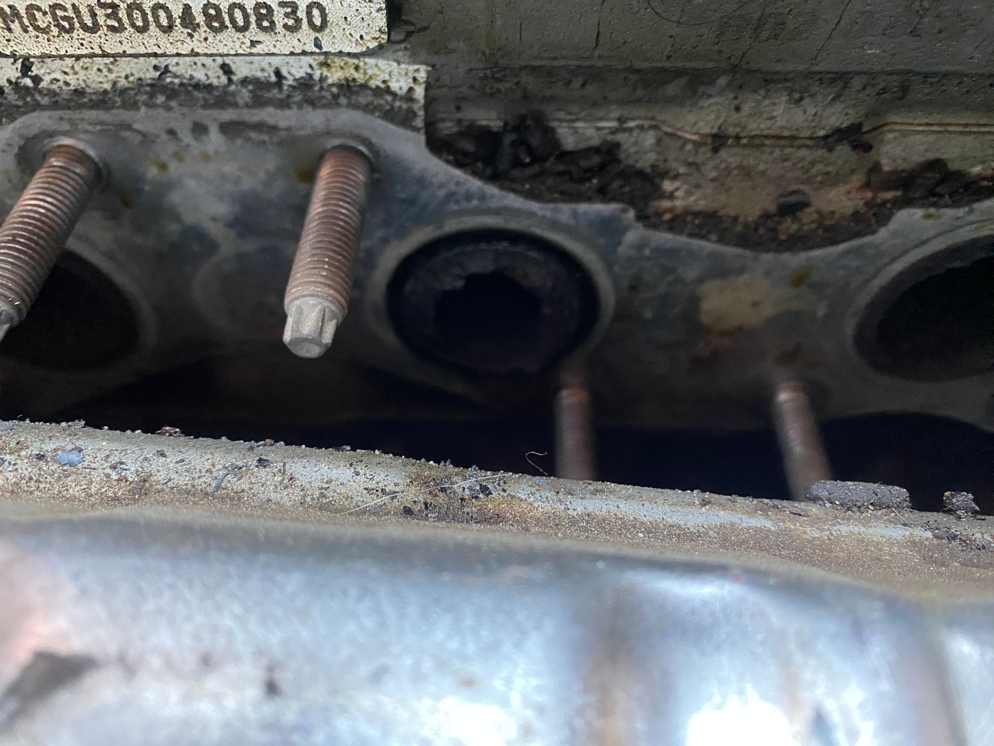

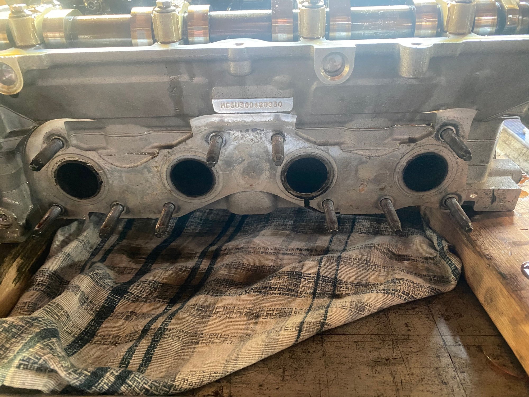

Update. I removed the cylinder head and stripped it checked for any movement of valve seats, none noticed unless they can drop a bit and then return flush?? Had the head cleaned as there was a lot of carbon buildup, not on the valves per se but rather in the exhaust port. Head cleaned a slight skim and valves lapped. Reassembled everything using new valve stem seals, of course reinstalled cylinder, head reset, adaptations, etc. fired her up and sure enough misfire and wet plug still present on 3 at around 100c…. Remove the cylinder head again and I’m currently sitting here. Scratching my head 😂 one thing I didn’t notice is the lifters as I call them are rockhard all but one which had a bit of cushion. The rock hard ones I could collapse, but had to use a pair of pliers. Not sure what those should be like when new?

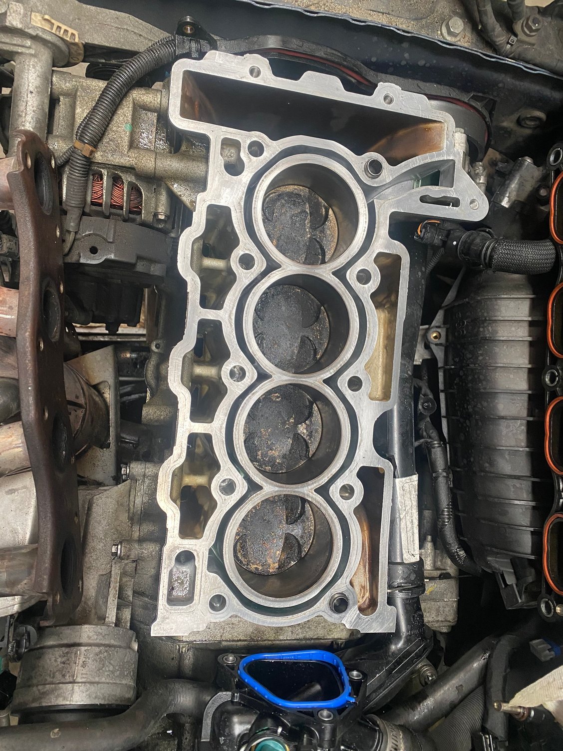

this is a photo of the crap dripping out of number 3 second time removed. And just to be clear, I bought the car with this misfire. The stuff dripping out of the cylinder is oily in nature, but doesn’t seem like oil and when I bought it and checking the spark plugs, they were all equally dark with no crust on #3 as I would have expected. As mentioned above, she runs perfect no noises until that magic 100c mark. I do notice vacuum buildup when removing oil filler cap at idle. I have checked the PCV diaphragm, and it has no rips.

Update - This time I decided to do a trick Ive done in the past to the valve seats found in early 2.0L VW air-cooled heads. I simply peened the valve seats on #3 and re-lapped the valves on 3. Happy to report this did the trick and can now idle the car until the cooling fan kicks in at 108C. Now on to figuring out why I get a idle surge for about 20 seconds on cold start.. Did get a code for intake Vanos movement. On to checking the condition of the non-return back valves at this point. I didn't realize they were there and they were left in the head during the cleaning/surfacing process so could potentially be full of junk.
