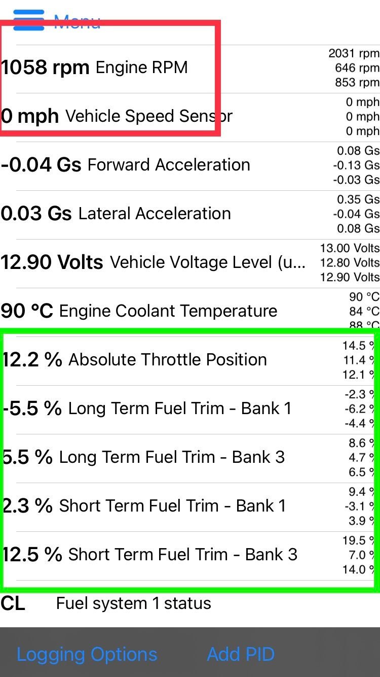

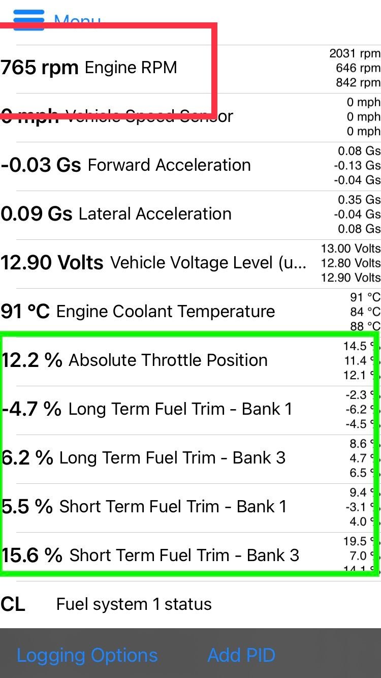

Runs good. Fuel trims seem off. Idles a little rough- not crazy.
I’ve had 3 different Indy’s check my compression and all had completely different numbers but each had cylinders within 12%
So I plugged in my handy dandy obd2 scanner and took these screenshots of fuel trims.
1 is at idle ~760rpm and the other ~1060rpm

Fuel trims seem completely normal.
If you're chasing a rough idle look toward the harmonic balancer or motor mounts.

Thanks. Harmonic balancer has about 25k (gel filled) I’ll check the motor mount!
