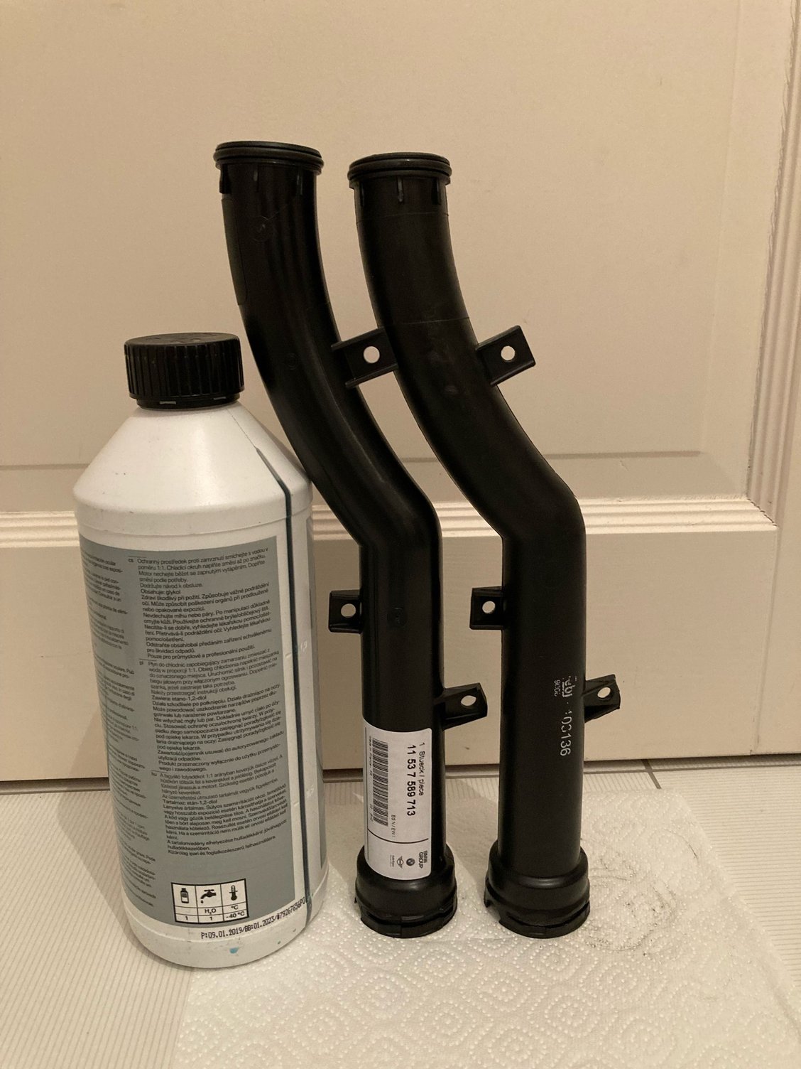

@mini-is-for-me Given that you have read the thread "R56 Coolant Crossover Pipe - Isnt there a better way": what o-ring are you using?
FWIW:
An R56 owner in Germany posted pictures comparing the OEM (i.e. made for and sold by BMW/MINI) and the Febi pipe. The difference in both length and the thickness of the o-ring is visible. Here's the pictures, along with pictures of the Febi packaging and label (in case you fear that you've been sold a counterfeit Febi pipe).
PS/Edit: The poster in the german forum also reported slight (but probably important) differences in molding quality.
Source of the comparison pictures: https://www.mini2.info/showthread.ph...758#pid2760758
Pictures of the packaging and lable are by me.
Wow, the differences look stark there. Yes, I just re-glued my old one back together so I could compare (it is still drying). However, I did notice the OEM O-ring width is small compared to the Febi one. I have no idea why people would sell this part and say it fits when you can clearly see the difference in these photos. So I guess I just wasted a bunch more money on parts.

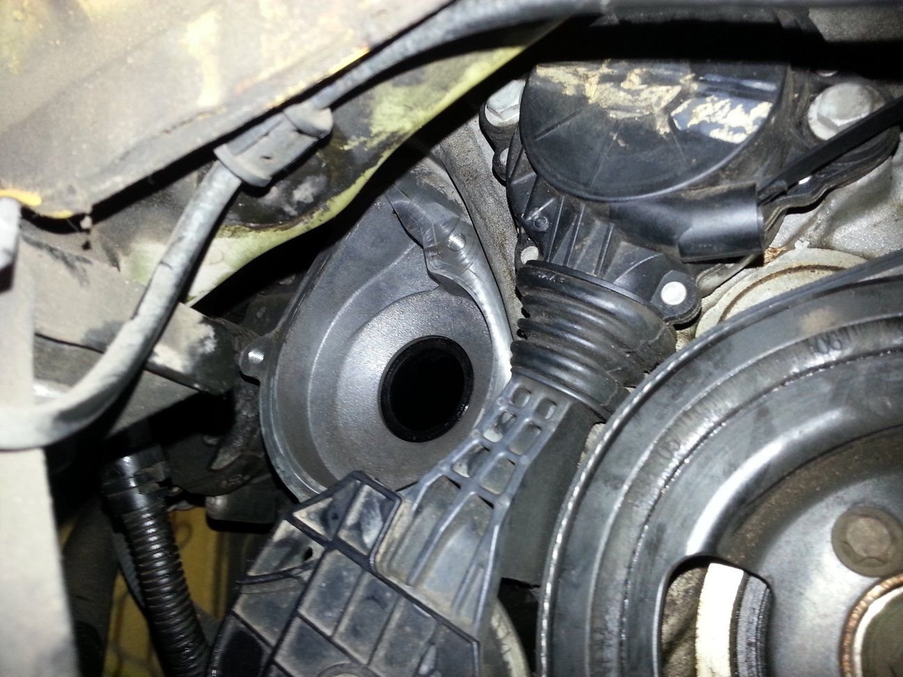

The orange should definitely be inside the water pump housing, otherwise it won’t seal. Are you sure there isn’t a broken piece of the old water pipe still left inside the pump housing?

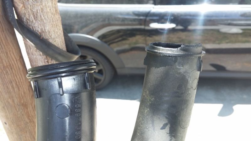

If your old pipe came off broken, it’s possible the very tip is still in the water pump housing, preventing the new pipe from fully seating:

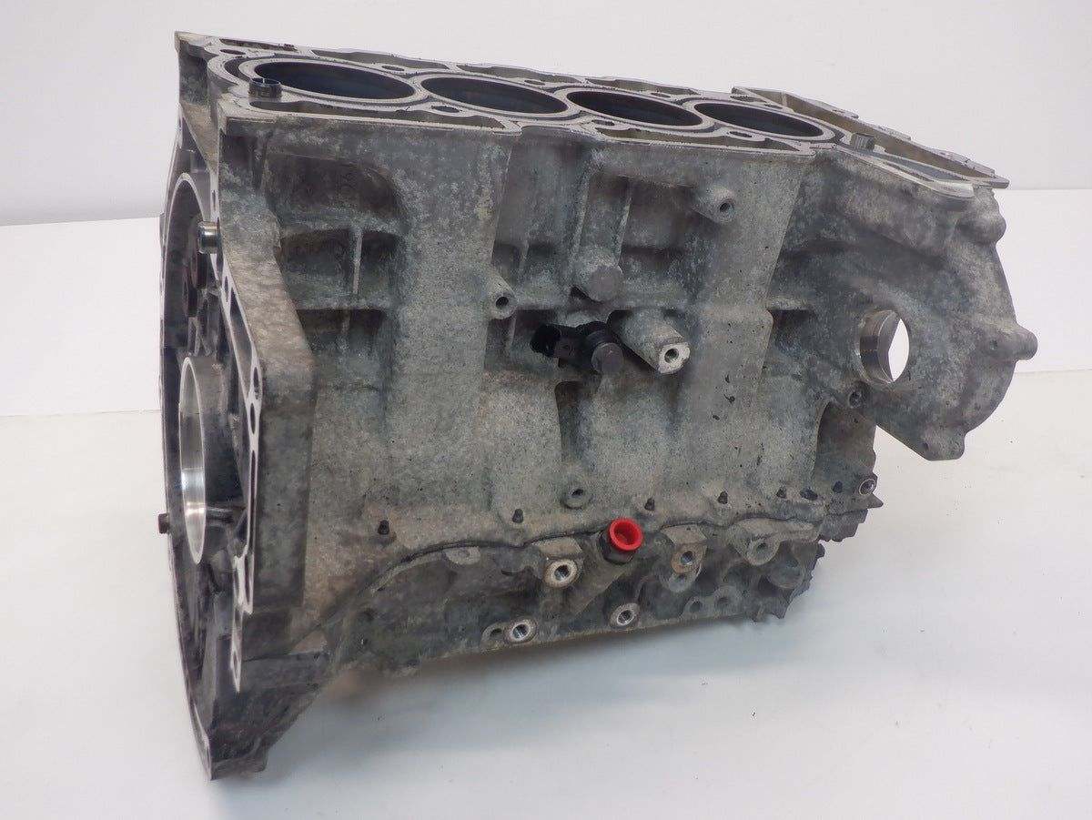

Look at this engine block, you can see the hole where the tube goes for the water pump. The tube should be almost fully seated into the hole, such that the tabs on the tube are centering it in the hole.
Here is the tube from inside the water pump housing, and you can clearly see how deep it’s seated:
If the tube is properly seated in the pump housing, when the thermostat is installed there should be almost no longitudinal movement of the tube. Then, the clip is installed to lock it all down.

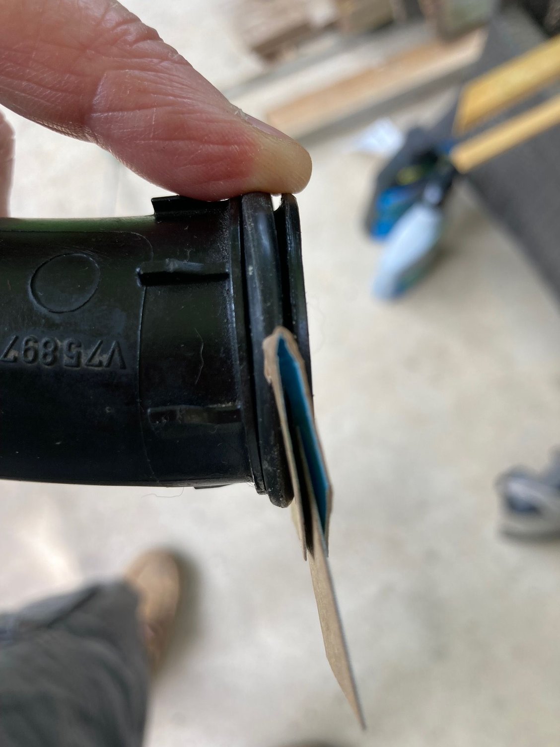

The only difference I see is the O-ring in this FEBI crossover pipe is at least 1-2 mm "THICKER" than the OEM. The O-ring in the OEM pipe has a little bit of room and it is loose inside of the groove so that it can "flatten" INSIDE of the groove and take up the rest of the space of the grove. Basically there is room in the groove for expansion. On the other hand, the O-ring on this Febi pipe has NO expansion room. Zero. It cannot flatten at all. It must go in "as is" and I can't get it to go into the housing any further. See this photo of the OEM pipe glued back together with the original O-ring and a piece of card board showing that there is lots of space inside the groove. My Febi pipe has ZERO room. The O-ring completely fills the groove. I don't have a picture of it because it is sitting in my car right now. However, trust me, it fills the entire width of the grove

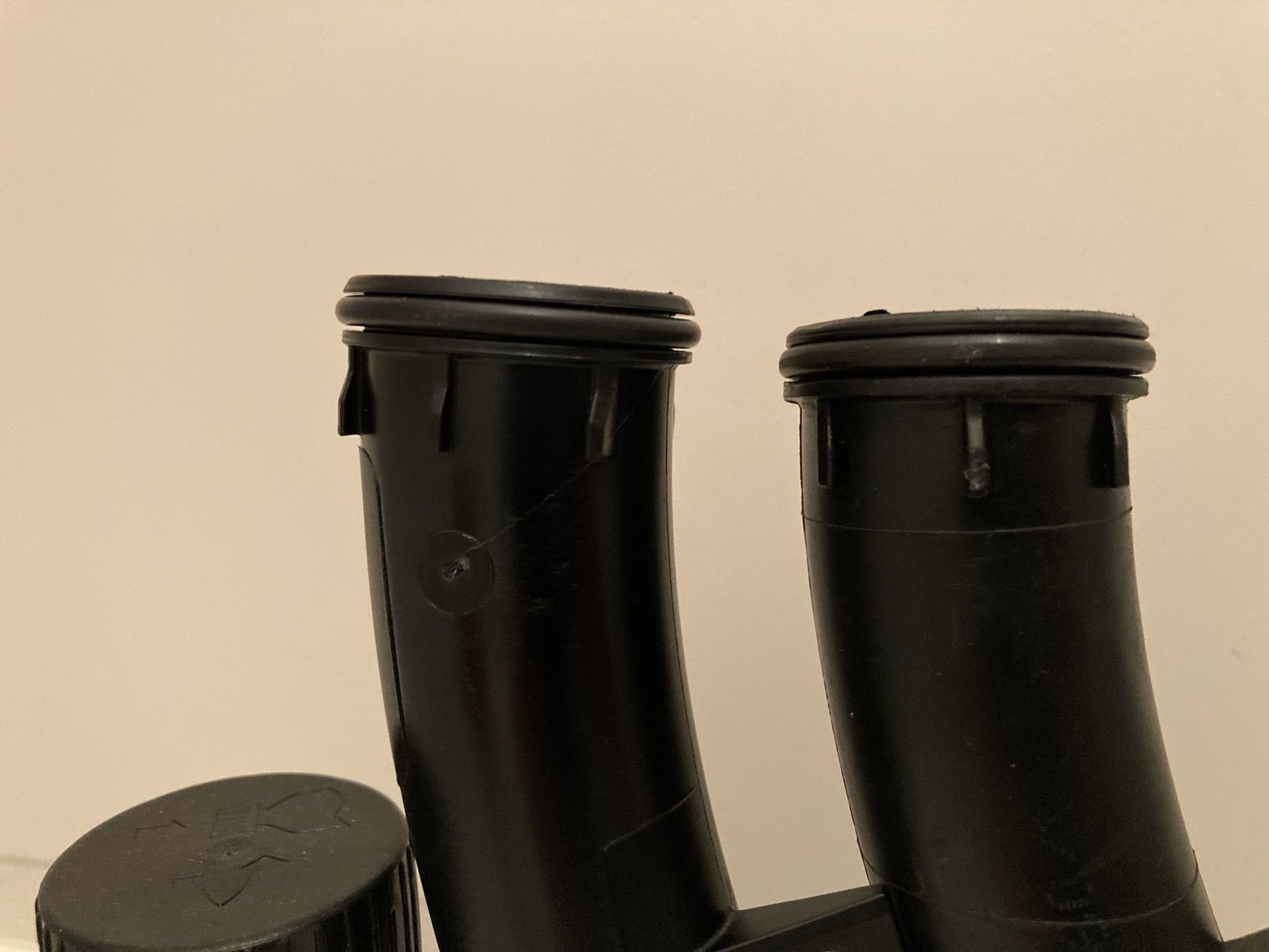

You see this picture above posted with the pipes side by side.
You see that little space I am highlighting with the red arrows on the OEM pipe. Mine is the Febi and that photo shows a "tiny" bit of space. However, on my actual part there is NO SPACE whatsoever. It completely fills the grove. I did my best to color in the grove.
It is the "only" thing I can think of...
I mean...I think if you could somehow get it to fit, it would be tighter. However, I believe I might have been sold more junk that doesn't work.... When I bought it the website said Febi was the OEM for this part.

I think your photos have me coming to the conclusion I need to purchase the OEM pipe. I mean it looks like I could go and get an O-ring and hope that is the only problem. However, with shipping that is going to cost me around $15. It doesn't seem worth taking the chance of having the car sit again for 2 weeks waiting for parts. I believe I have been ripped off again with inferior parts. I had to go and buy the OEM water pump and it was literally night and day size wise.
What I am starting to see is that the "tolerance" on all these parts is RAZOR THIN. They can't be "almost-like or nearly like OEM". If they are not EXACTLY like the OEM and if they are just 1mm off, they simple DON'T FIT!

So my solution to the problem was exactly as I illustrated above. The OEM pipe fits like a dry glove. The extra 0.1-0.2 mm larger size of the FEBI O-ring prevents it from "contracting" under pressure. The OEM pipe has a slightly smaller (width) O-ring. So as it is squeezes into the water pump housing, it deforms and slightly flattens to fill up the remaining space in the grove and seal against the inside of the water pump housing. The Febi O-ring on the other hand, has no place to squeeze down to. It fully occupies the entire space in the groove already. So, it just sits there on the end of the housing unable to enter the water pump housing. The same problem exists on the other side. The OEM Thermostat fits easily into the OEM Pipe. However, the Febi pipe is much tighter. It is possible to get it to fit off the car albeit with a lot of force. When you try to install it with the Thermostat bolt torque, it would rather deflect and not go in because it also can't go into the water pump housing on the other side of the pipe anyway.
Could I have used massive force to make these work? I can't say it is impossible but very unlikely. More than likely it would have deformed the crossover pipe or damaged it. Save yourself lots of headaches! I know the after market pipes are $15-$35 and the OEM pipe is $80+. It seems like you are wasting a lot of money on a basic piece of plastic. You will burn through that time difference after the first hour of frustration.
See the Febi below--NO ROOM!
