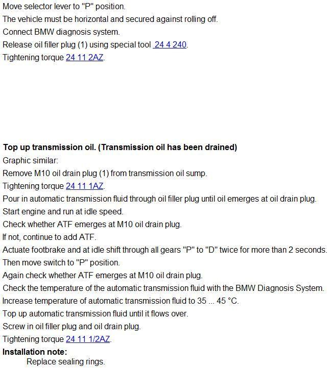

While it wouldn't explain the two weeks after the AT filter and gasket replacement, during which the car worked fine, there is no harm in checking the fluid level (assuming of course, that it is of the right specification in the first place).
However: It is not simply a job of unscrewing a couple of nuts and pouring in oil until it overflows and then wait until overflowing stops:
1. The car has to be level and at the same time accessible from both underneath AND top. So this is not a two-hands, curb-side job.
2. Due to AT fluid's significant volume increase as it gets warmer, the only way to make sure that the fluid level is correct is to monitor its temperature and only check its level when it is within the specified temperature window (IIRC between 30 and 40 degrees C correct: between 35 and 45 degrees C, see my post below). Doing this by measuring the temperature of the overflowing oil is not only very inaccurate, it is also not possible if the AT is underfilled. The only "right" way is to access the AT fluid temperature with an appropriate OBD scanner (both ISTA and Deep-OBD I mentioned above do so).
And since the op went to a shop for a gasket and filter change (instead of doing it themselves), I would also throw in a couple of "noob" hints like:
- make sure you first loosen the ATF filler plug BEFORE opening the drain plug!

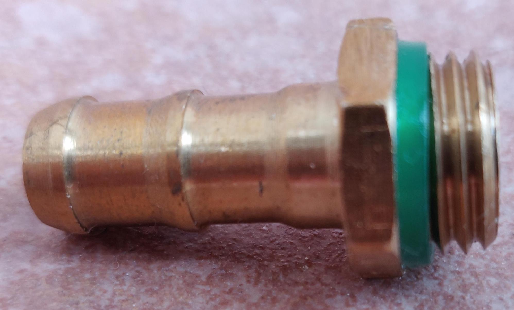

- there are two filler plugs available: one from the top (easier for non-turbo models to access), one from the left (accessible through the left hand wheel arch). EDIT: For this procedure, the correct filler plug must be used. See below posts for more information!
- whichever filler plug is used, try to get a screw-on hose adapter. Otherwise, filling in fluid becomes very messy.
- if not 100% confident that the car was produced for the US market (and was not e.g. imported from Canada or elswhere), first find out which AT is fitted (see my previous post above) in order to make sure you use the right specification fluid. By the way: ISTA also reports the kind of AT fitted.

It's not me. It actually is BMW. And apologies, the specified temp window is 35 to 45 degrees C.
PS.: Why is it hard to remove the filler plug on the side? After removing the wheel arch liner, the plug is on full view. EDIT: The filler plug on the right should only be used if ATF is filled while the engine is NOT running!

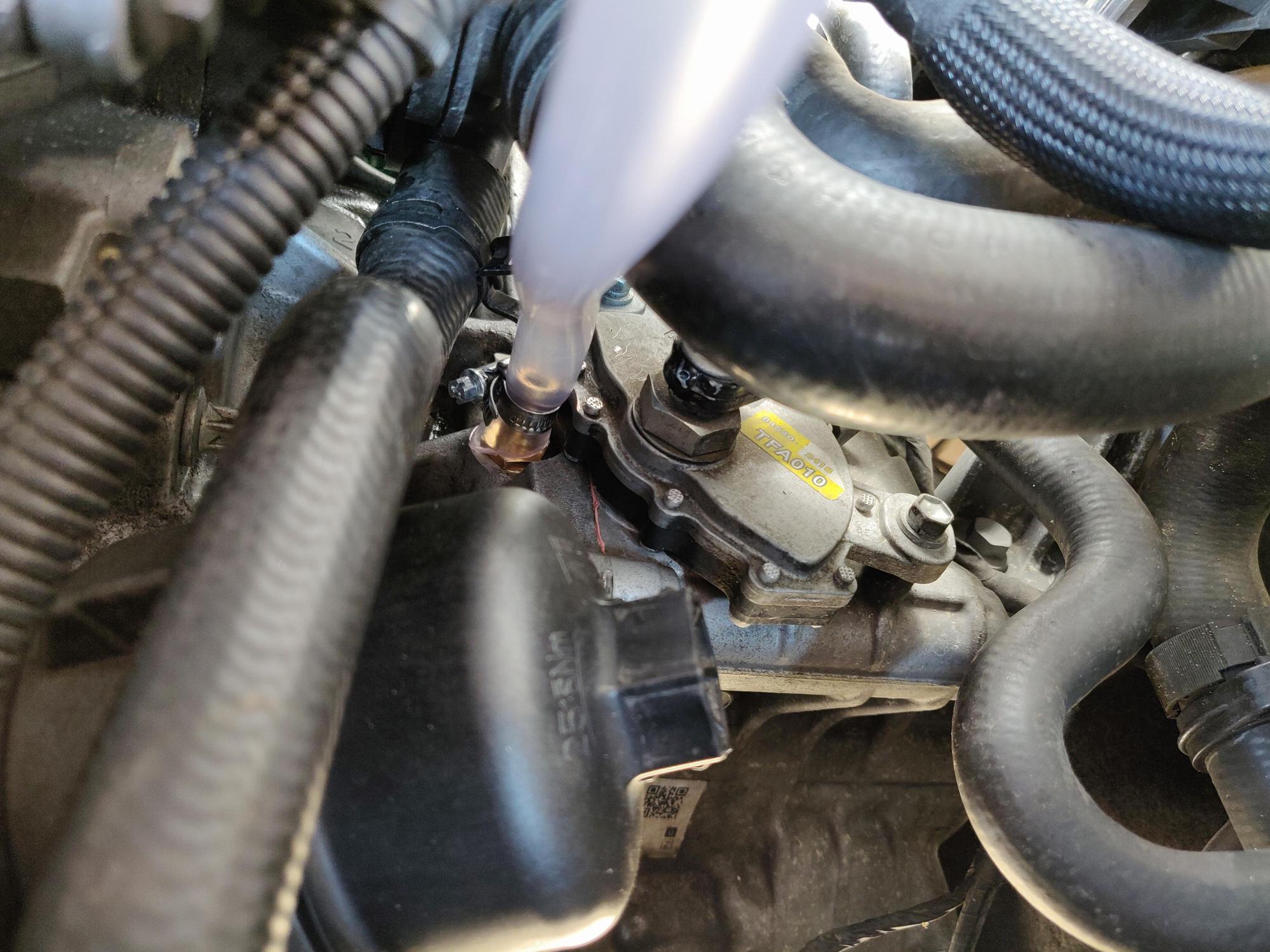

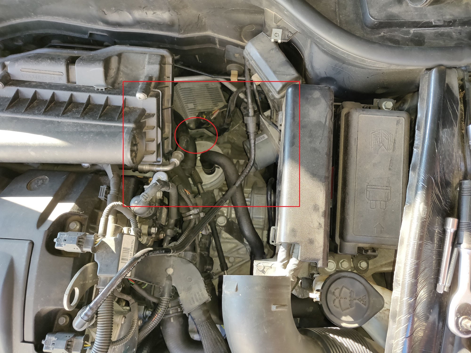

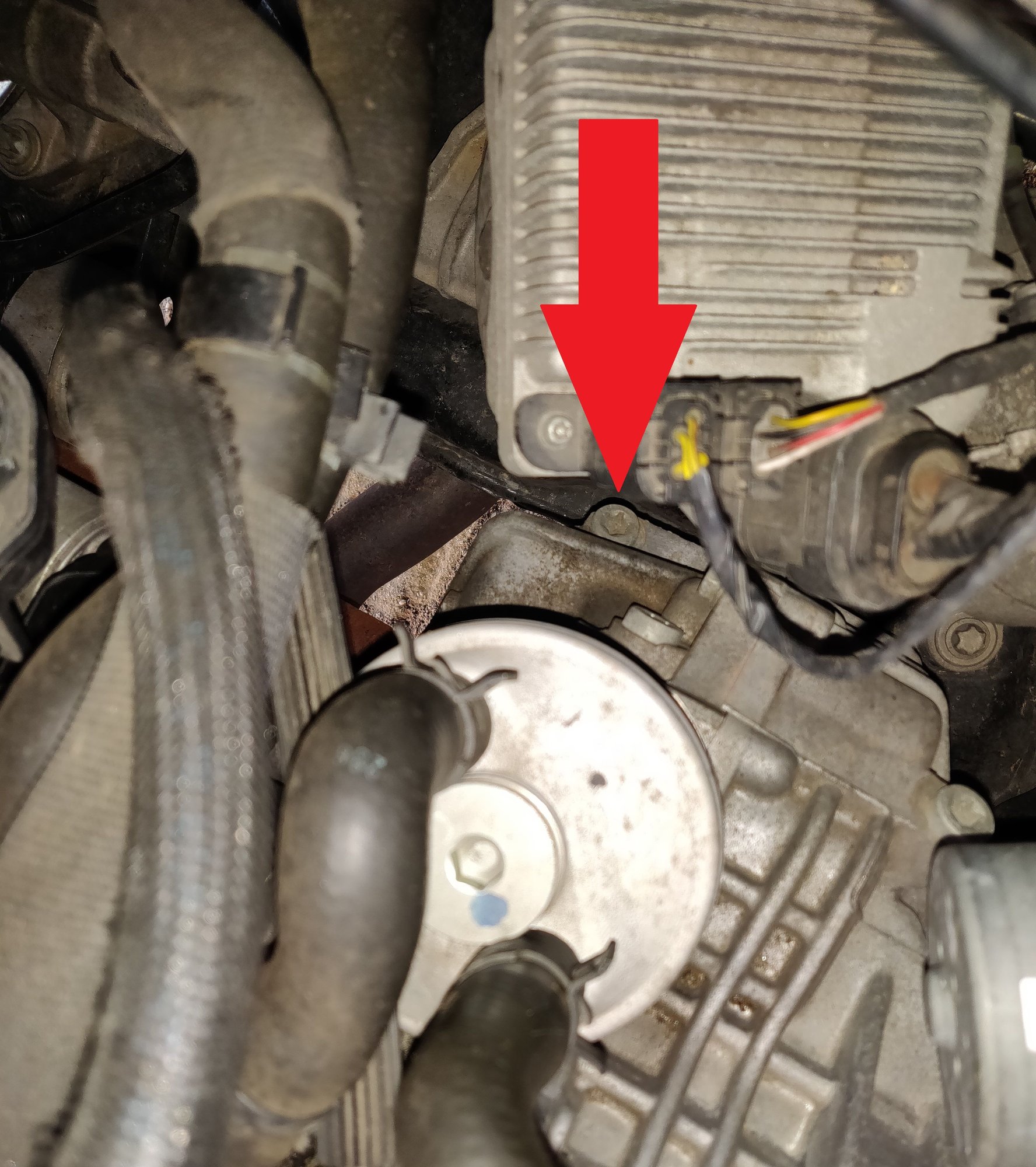

Since you have an N16 engine (and thus access to the top filler plug is a bit easier compared to an N14/18), you only need to remove the intake silencer to access the top filler plug. Try to get an adapter like the one pictured (I got mine from a local parts shop for agricultural machines).
EDIT: The filler plug shown in the second of these pictures can only be used for filling in ATF while the engine is NOT running!

@giorgos What is size of that adapter? Maybe I can find a local agricultural company nearby that has something similar
- There is no minimum/maximum fill line (the instructions I posted above are BMW's official instructions towards its service staff).
- ATF's of the correct specification can be mixed. I'd choose one which has official manufacturer's approval (rather than states something like "meets", "recommended for", "exceeds", etc. on the can), if available fully synthetic.
- I have never read anywhere that the exact transmission model type is stated on the transmission and/or the car. I found out about the transmission type in my Mini by using ISTA.
I don't have the hose-adapter with me at the moment, but I remember seeing information for the thread type on RealOEM when looking up the part number for the filler plug. Even so, I took the filler plug to the shop and the sales person there identified the thread. Note: the two filler plugs discussed in this thread are different in size.
Btw.: the pictures included with the BMW instructions above show yet a different filler plug to these two.

this is NOT the fill plug . Regardless of it being N14 or N18, the transmission case/shell is the SAME. the fill plug is in the back towards the electric power steering motor.
this hole opens to a tight tube the runs inside the transmission. pouring atf will take forever and not to mention the mess it will create once the engine is running!
Thanks MiniToBe for setting this straight. I admit that I didn't think about whether using this plug will work while the engine is running (as required by the official BMW top up procedure). I used it for filling ATF after heaving measured the precise weight of the fluid that came out so I wasn't affected.
Here is the filler plug referred to in the BMW instructions:
yup perfect 👍
Generally speaking, don't always put back the same quantity of what came out. Over the years it could've been reduced or even over filled at the factory. So always fill it until it drips, then run the car and continue to fill, then run through the gears and fill untill it starts dripping again 👍👍

Is this the filler plug?
According to the BMW instructions, the torx socket has to be sawed off in order to fit. However, the space in my N16 LCI seems to be sufficient to maybe reach and remove this plug from above (after removing the intake silencer box only). And even if removal from above is not possible, filling up from above sure is. Judging by the looks of this plug, its threading may even be the same as the threading of the (wrong) plug on top.
Overview (from above):
Plug in question:
Plug in question:
Yes that's it. It is a T55. I use a 10mm with the bit to get it going. It is SUPER tight so take your time on it. I also sometimes remove the bottom motor mount to swing the transmission away just a bit.

Originally Posted by eh-Thomas
I’ll need to get an extension and I've got a syringe and tube style of contraption to pump fluid into that top opening.
Do yourself a favor and get a hose adapter like the one I pictured above. If you find you can't fill in the ATF via the actual filler plug, use a (different) hose adapter to fill in through the drain plug. The drain plug has an M10 threading (and if I'm not mistaken, the filler plug is an M14).
